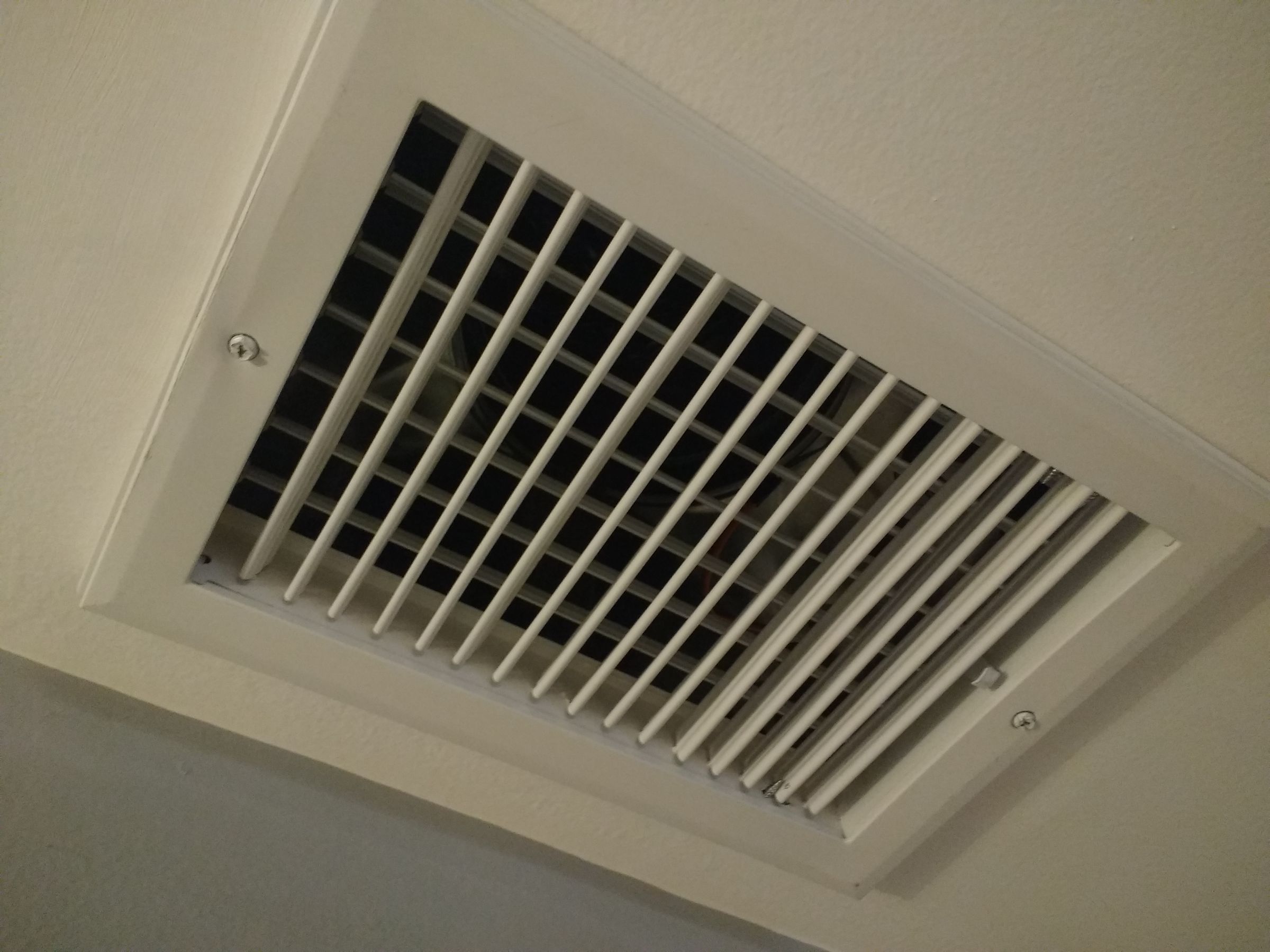

This started as a standard 12"x8" ceiling register with manual damper lever. I wanted the modifications to be reversible, if possible, in case the system didn't work.

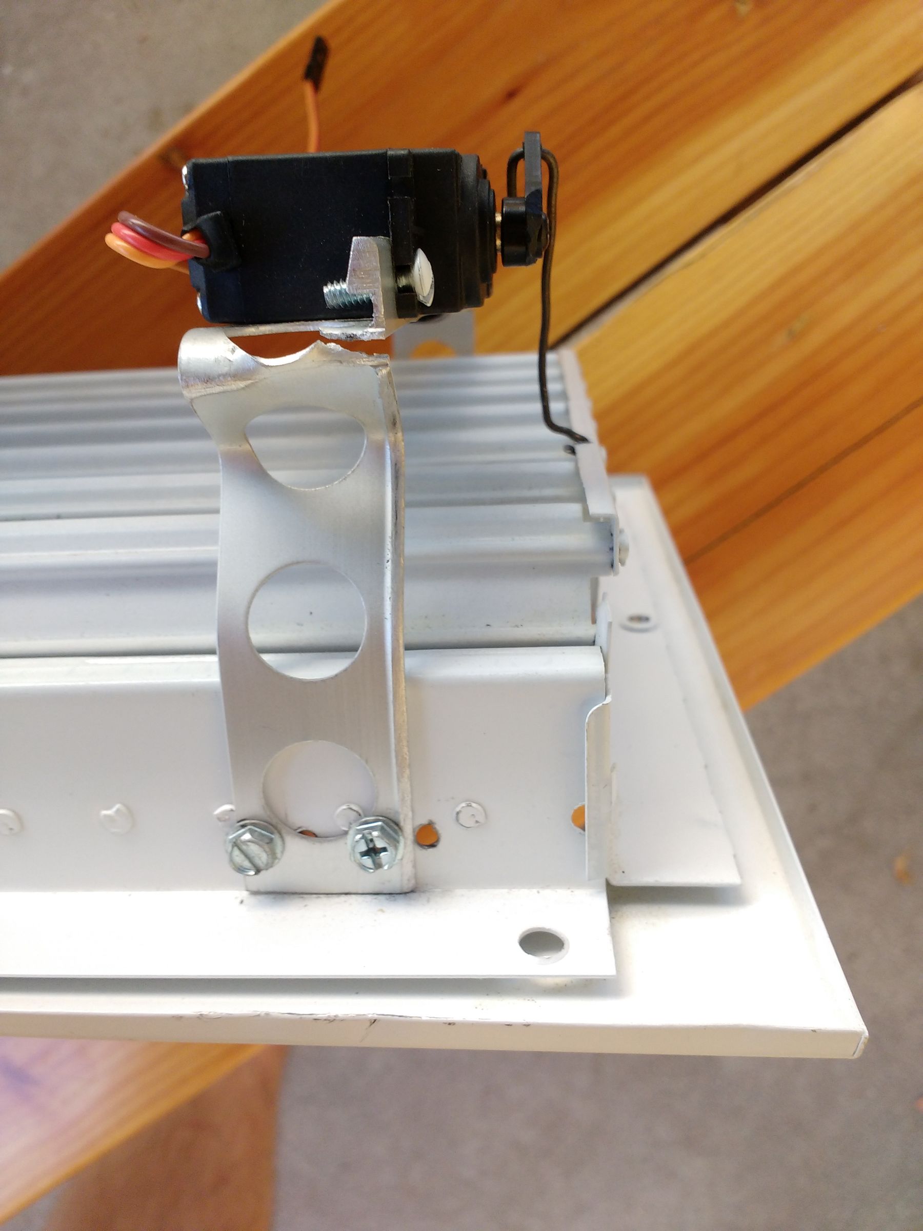

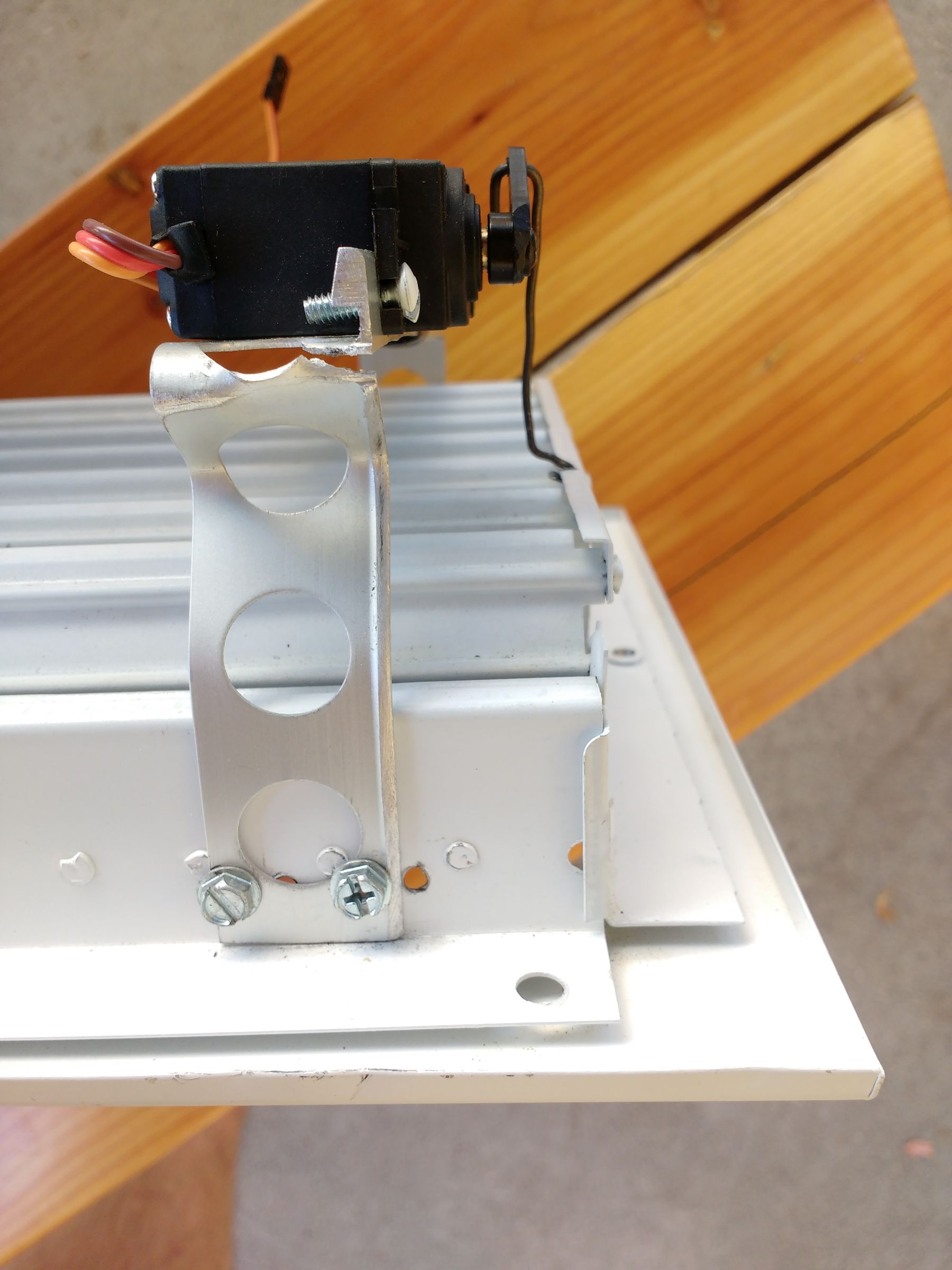

Servo bracket
The bracket is made from a strip of aluminum angle that I had spare. This part was probably the hardest to get right, as it needs to hold the servo in the right position, without jamming in the duct when the register is fitted. My register is fitted to a tapering duct box, so there was just enough space if I moved the servo away from the edge by about 1". When I test fitted the register, the servo was too high, so I bent the bracket to lower the height. This caused a crack on one side, but it still works.

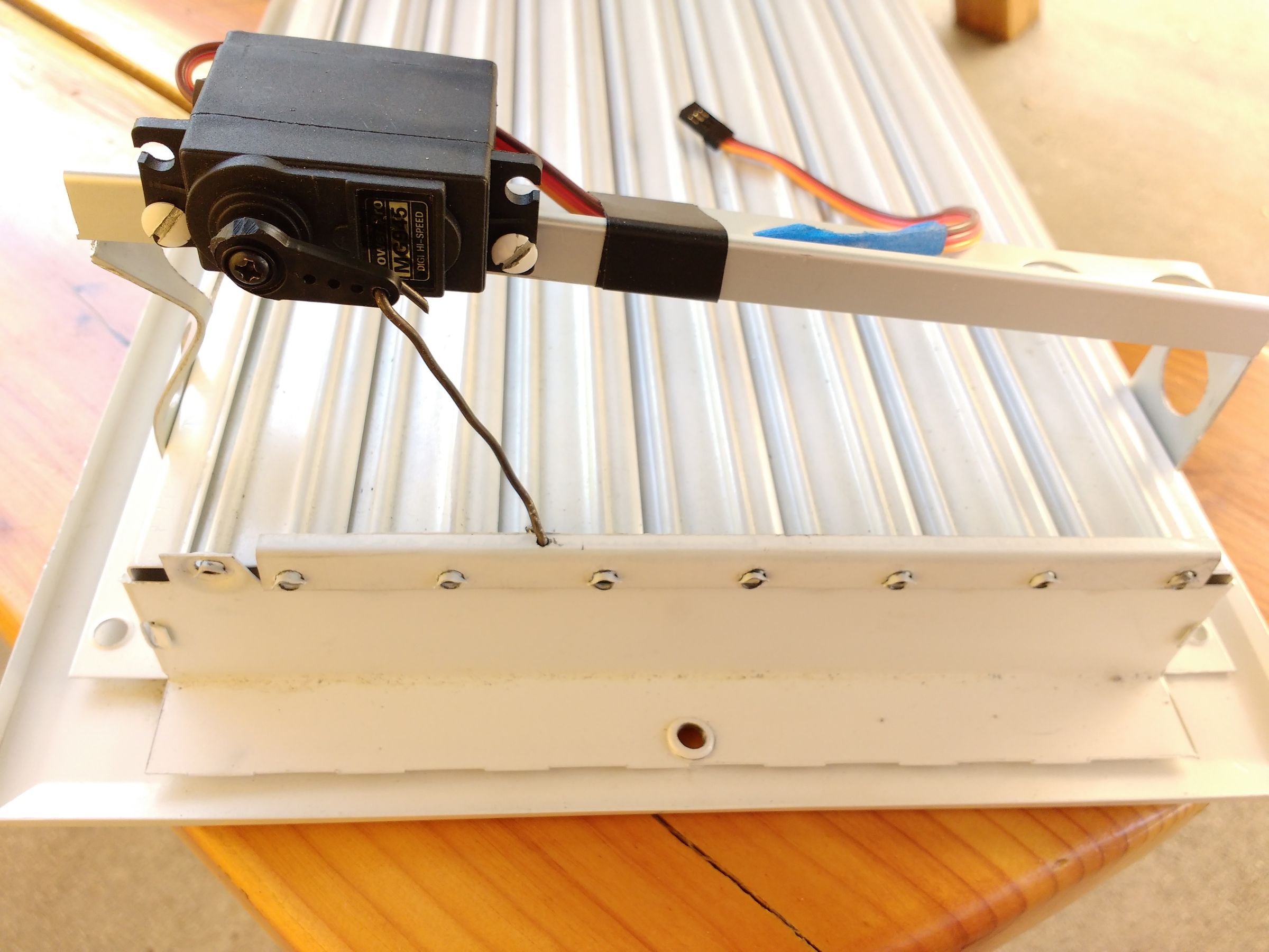

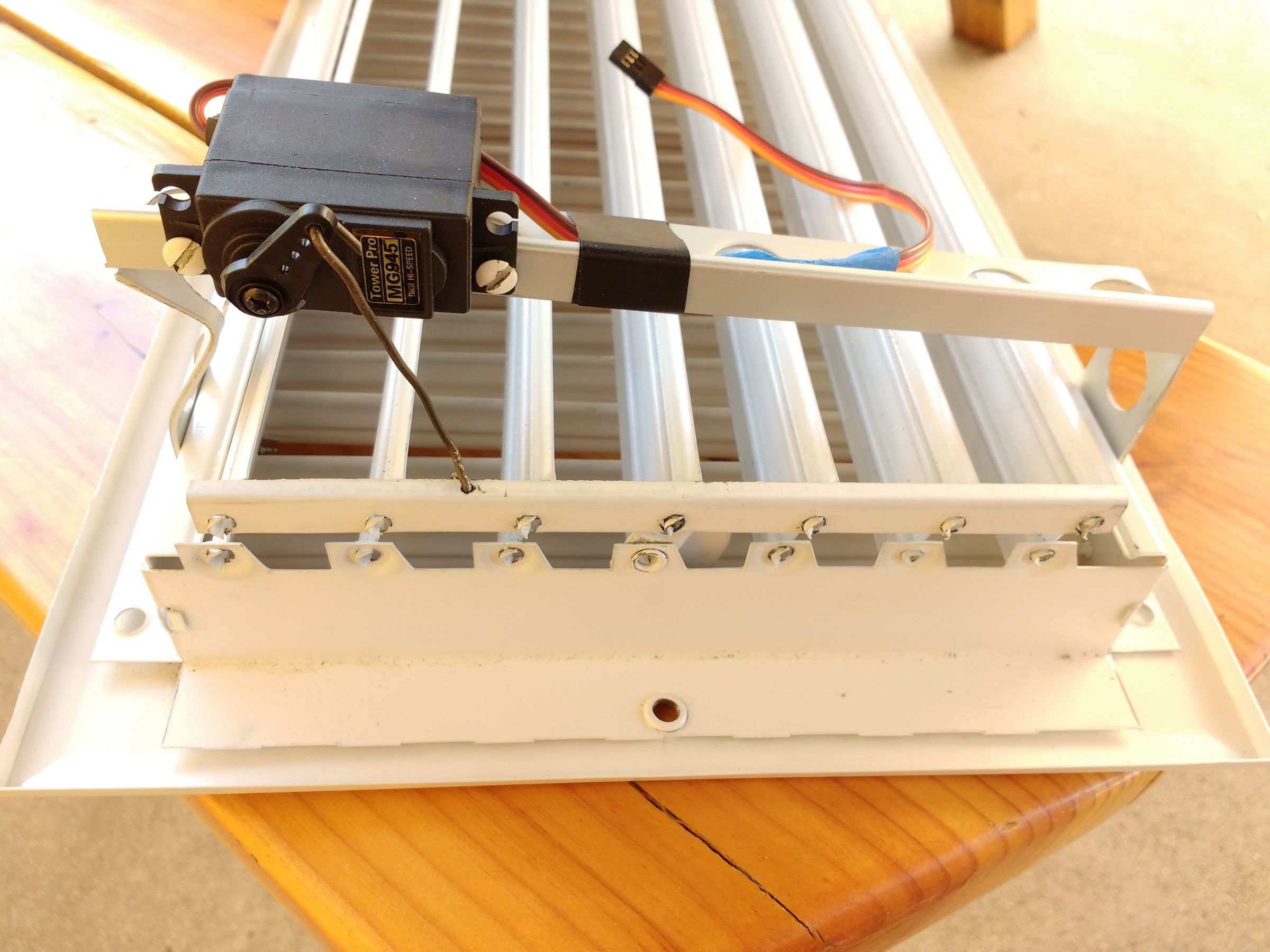

Servo position
The servo has to be positioned so that the servo horn can pull or push a rod connected to one of the linkage points. You will have to experiment with different bracket dimensions to make sure the action works correctly. The vanes of the damper should open and close completely, without running out of servo range.
The following photos show the opened and closed positions. The servo horn should be roughly parallel to the vanes.
For easier adjustment, set up your servo so that you don't need the full range of servo motion to control the vanes. The final angles can then be set by adjustments in the Arduino sketch, rather than by mechanical adjustment.
Servo in open position
Servo in closed position
Link rod
I used some steel wire to make a link between the servo horn and one of the damper vane pivots. This will take some trial and error, as you need to bend the wire to fit into the pivot and connect back to the servo. If your servo is not in line with the pivot (because of space restrictions in the ductwork), you will need to add a bend in the wire to translate the movement into the right plane.
The link rod must not interfere with the closing vanes - I attached it through a hole drilled in the top of the frame that carries the top links of the vanes. You could also try fitting the rod inside one of the pivots from the end, but I found this was unreliable and the wire would come loose.
You could use a thin strip of metal rather than a wire for added stiffness.

My duct opening is 12"x8". Your setup may vary from this, depending on the size of the register and the amount of space available within the duct. Smaller openings will be more restrictive for servo positioning.
The servo bracket needs to be rigid enough to resist the force of the servo pushing and pulling the vanes, otherwise it will not open or close fully. I fixed the bracket to the frame using sheet metal screws. Pre-drill screw holes and avoid having screws too close to the vanes.
Because the servo horn has a limited range of motion where it can push or pull effectively, you need to make sure that the open/close action of the vent fits inside this range.
If the servo comes up to its own limit stops the vanes will not open or close fully. You will need to reposition the servo horn on the servo drive spindle, so that the horn can move freely between the opened and closed positions without hitting the limits.
I attached my link rod to the hole at the end of the servo horn, and measured the rod so that the servo has extra movement on each end of the range. This range will be fine tuned later in the software. If your servo can't open and close the vanes fully you will need a longer servo arm, or to glue on an extension.

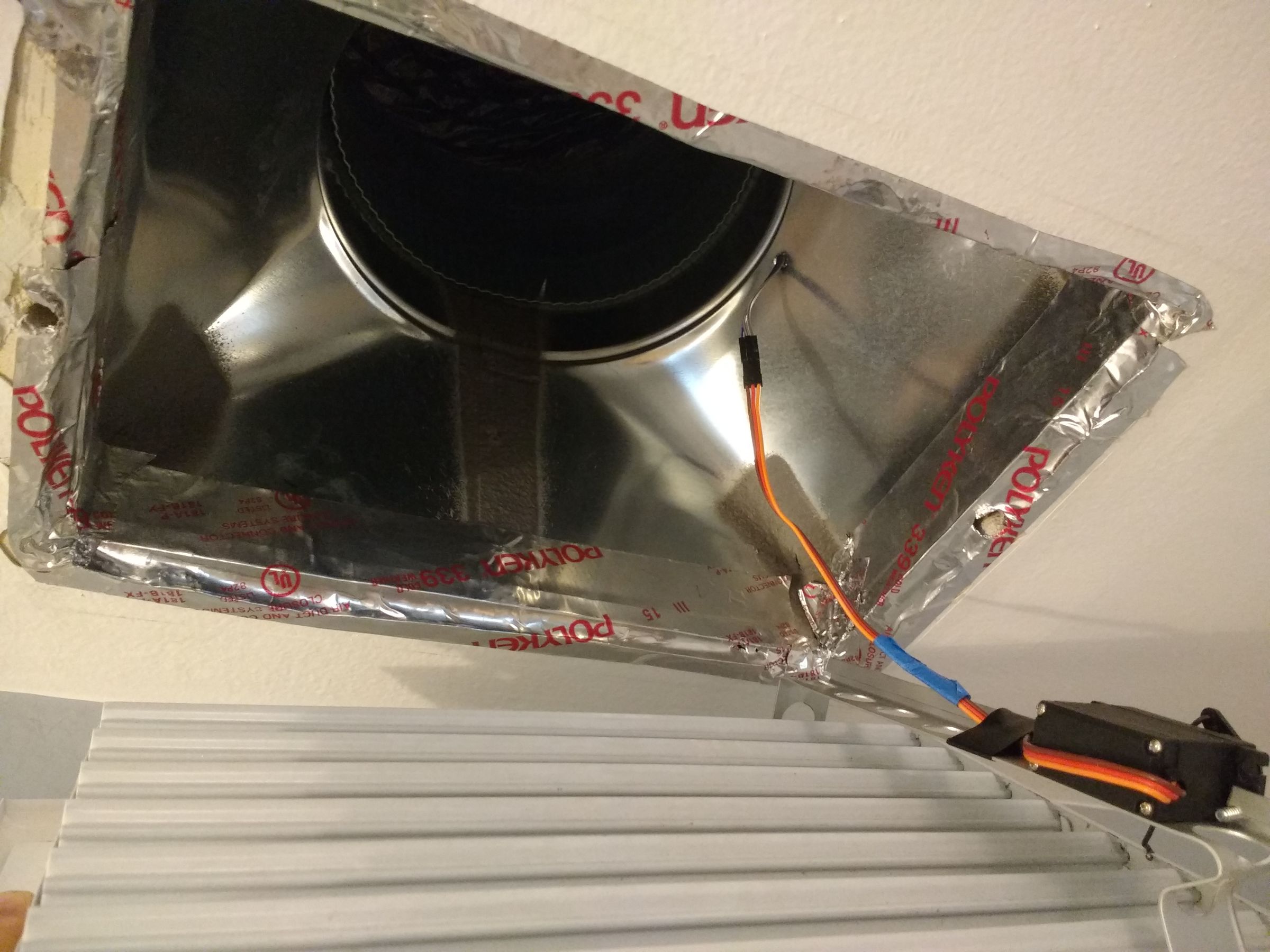

Servo wire extension
Installation is easier if you have 2-3' of wire between the servo and the controller. Use a specific servo extension cable or three solid core wires, with similar color coding to the servo wires. Tape the connection to prevent it pulling apart.
For testing you can run this extension wire out into the room and plug it into the Arduino. This makes things a lot easier to adjust than when it is all hidden in the attic.

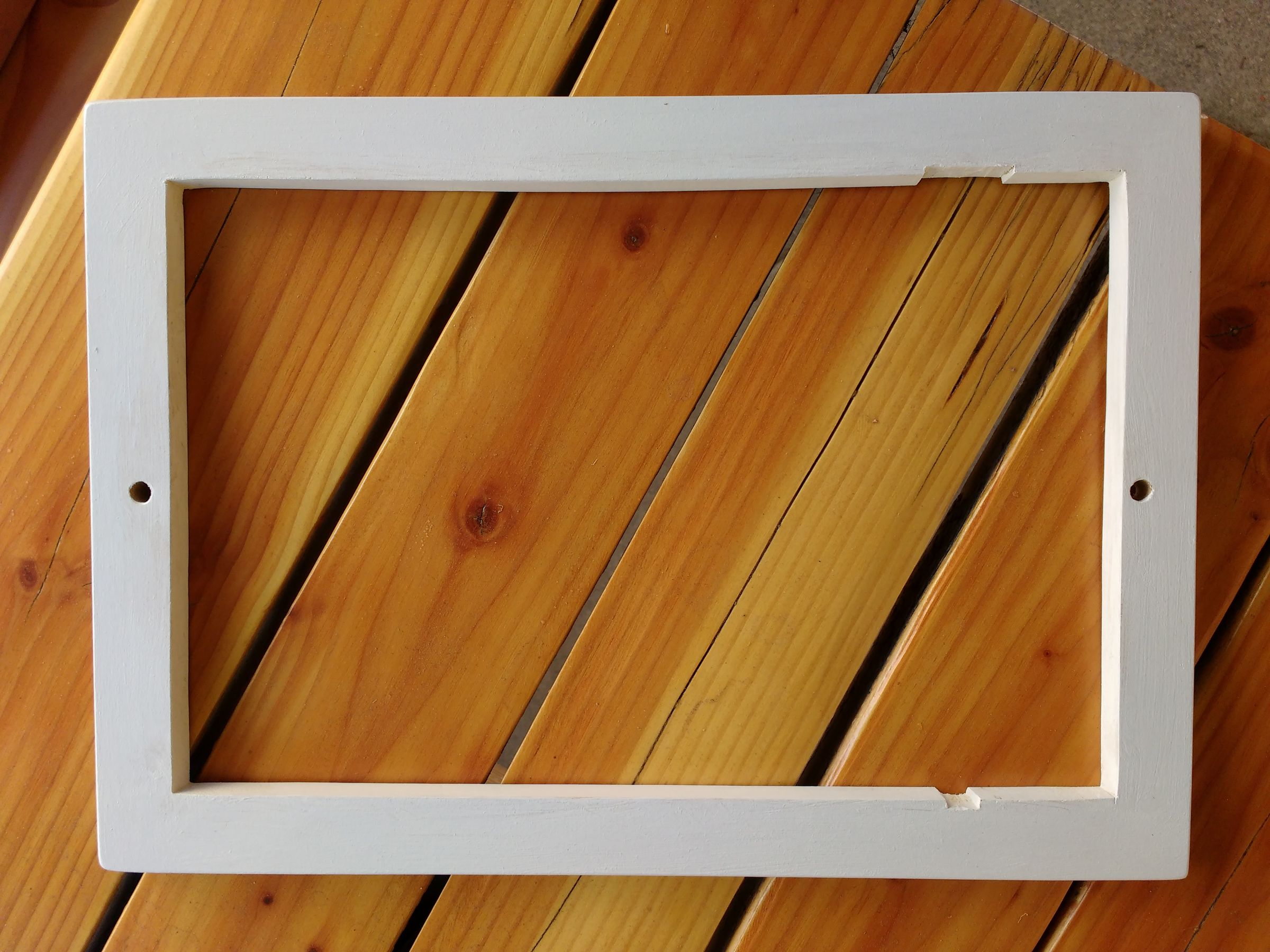

If space is a problem
When I tested the servo action before installing in the ceiling, it worked properly, but when installed the servo horn would snag on the inside of the duct. I adjusted the bracket by bending one side (cracking it in the process), but still couldn't get enough clearance for full movement. In the end I added a spacer between the register and the ceiling.
The spacer is ½" MDF, painted white. I cut a piece of MDF ¼" wider than the register edges, then cut out a hole to fit around the mechanism. This extra ½" of clearance was enough to allow full servo movement again.

Step 11: Final Installation
Once the software has been tested, it's a good idea to put the electronics into an enclosure for protection. I used an old external hard drive case.
For an invisible finish, you will need to hide all the wiring. Move the controller into the attic, or a suitable space next to the ductwork. You will need an electrical outlet near the Arduino to provide power. If the air handler is in the attic there should be an outlet next to it, otherwise you will need to have an electrician install a new one. This is relatively simple if power can be taken from a ceiling light fitting.
Drill a small hole through the duct into the attic/adjacent space. Fit the spacer onto the register.
Run the servo wire, with extension, through the hole, being careful not to damage the cable on the sheet metal. Leave enough wire visible to be able to access the servo for maintenance, and then tape the hole closed with aluminum duct tape. Replace the register.
Place the controller on the other side of the duct and reconnect the servo wires. Tape the connection to prevent it pulling apart. Plug in the power supply and listen for the servo test sequence. It helps to have someone else watch the servo to make sure it is still working properly. The sequence should end in the open position and will close when the next close alarm arrives (7pm in the example).

Step 13: Overcoming Project Difficulties
This project began as a simple idea, with a seemingly simple solution. In the end it took much longer than I expected, with much frustration and many hours working out solutions to problems I didn't expect. These sections were the most problematic, so I've added some tips.
Link rod position and shape
It took a lot of experimentation to get the right wire for the link rod and to get it bent into just the right shape. This process is trial and error but you'll get there with enough persistence!
Fitting servo and bracket into duct space
The restrictive space inside the duct was just slightly the wrong size for my servo and bracket. It took lots of adjustment and eventually an extra spacer to get this to work. I'd recommend keeping the servo as low as possible to give it plenty of space, and moving it in from the edge by an inch or so.
