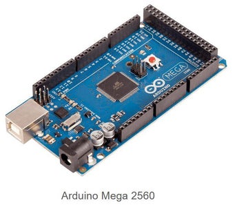

  1. Arduino board (recommended Arduino Mega 2560 for more pin spaces, as we have a lot of components to connect)

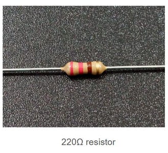

  8. 8 of 220 Ω resistors

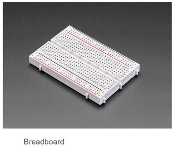

  12. Breadboard

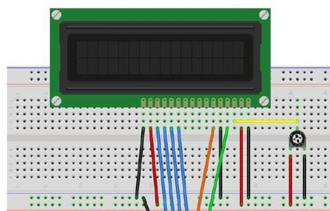

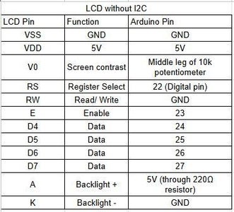

Step 1: LCD and Potentiometer Wiring (for LCD Without I2C)
The table above provides the LCD wiring. As you can see, we have 2 LCD pins that need to connect to a 5V source (VDD and A) and 2 LCD pins for the GND source (VSS and K). Most Arduino boards only have one 5V source and 2–3 GND sources. In our case, many other components also need to use a 5V source and GND. Therefore, for every connection to the 5V source, we will connect to the positive (+) rail of the breadboard, and connections to the GND source will be connected to the negative (–) rail of the breadboard.
  1. You also have to download the library LiquidCrystal.h from Arduino in order to be able to program this component.
The reason I chose pins 22 to 27 for (RS, E, D4–D7) is that I want the LCD wiring to be in the same section on the Arduino Mega board for easier debugging later (if the system does not work). You can assign them to any digital pins you like, but remember to update them in the code (I provide the code in the final section).

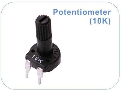

For the potentiometer, the upper leg will be connected to V0, and the two lower legs—one will be connected to the positive rail and the other to the negative rail. You can see from the figure.

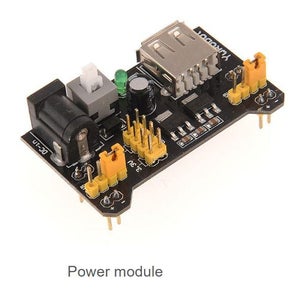

Step 2: Connect Power Module
The purpose of a power module in Arduino projects is to provide a stable external power supply to your circuit when you're not using USB power from a computer. However, there is a big note. In the picture above, the way the module places on breadboard makes you feel that both sides (+ and - on each side) of the breadboard will have power from the module. However, it is not the case. Only the bottom side (where it has black port) will be provided with power. If you want the upside to be powered, you must have 2 wires connect the + from left side to the + from right side (same thing with - rail).
You can see in the wiring picture, I have red jumper wire goes from + rail from 1 end to the other end. Same thing with - rail.

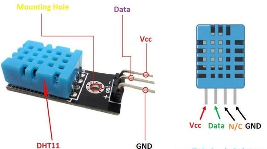

Step 3: Temperature and Humidity Sensor Wiring (DHT11 Sensor)
I include the picture above the wiring diagram for both the 3 pins and 4 pins DHT11 sensor. Remember:
  1. In order to be able to program with this sensor, you have to download DHT.h library from Arduino
  2. For VCC and GND, I just connect to the (+) and (-) rail of the breadboard.
  3. For Data pin, in this case, I connect to Digital pin 12 on Arduino Mega. You can connect to any Digital pin you want, just remember to update the code in the section below.

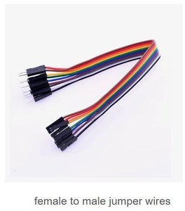

If you have Female-to-Female jumper wires, you only need 6 of them and it will make your life much easier. For soil moisture, the order of the 2 pins go to the 2-pin side of the amplifier does not matter that much. However, for an amplifier, the wiring diagram is below:
  1. A0 can be connected to A0 pin on Arduino Mega.
  2. D0 can be connected to Digital pin 8 on Arduino Mega.
  3. VCC and GND can be connected to the (+) and (-) rail of the breadboard.
If you don't have Female-to-Female jumper wires, you can use Female-to-Male jumper wires and connect them like in the 2nd pic of this step.

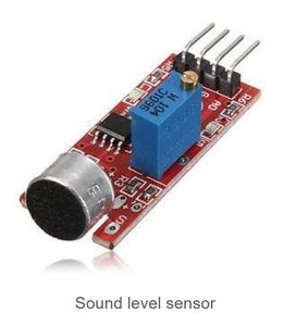

Step 5: Sound Sensor Wiring
I include the picture above the wiring diagram for Sound sensor. Remember:
  1. For VCC and GND, I just connect to the (+) and (-) rail of the breadboard.
  2. For D0 pin, in this case, I connect to Digital pin 3 on Arduino Mega. You can connect to any Digital pin you want, just remember to update the code in the section below.
  3. For A0 pin, I connect to A8 pin on Arduino Mega.
Before using the sound sensor properly, you have to use a small screwdriver to twist the yellow small screw and keep talking near the sensor until you see it blink whenever you talk to the microphone. Use the test code attached in this step to test your sensor

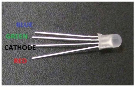

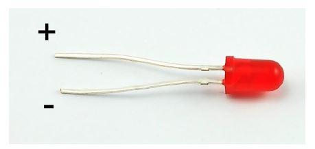

Step 6: LED Wiring and RGB LED Wiring
Above is the wiring table for 2 RGB and a Red LEDs. You can definitely change the pins to your convenience. Just remember to adjust that in the code for the below section.
  1. 1 RGB LED will be used for DHT11 sensor threshold. The other will be used for soil moisture sensor threshold.
  2. The Red LED
  3. As you can see, I tried to put all the LEDs to one side of the board just to make it easier for user to see the threshold signal.
  4. Remember, every signal leg of LED (like leg that code for color), you have to connect with 220 Ω resistor before go to Arduino board
