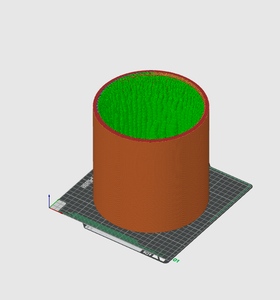

I started with a cylinder because I felt that was the best shape for a coil and I made it 10 inches in diameter to hopefully fit a phone and some other items (won't work due to scale down to 80%). I tried to leave a thick enough brim to hold a thread but also not affect the amount of space inside the shoot.

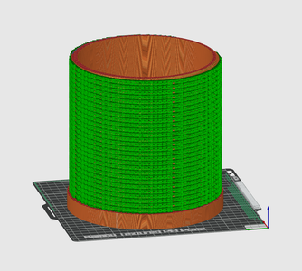

Next, I made the internet piece by making a cylinder that fits perfectly into the first piece I made. I had to shell out this internal piece too, also leaving an edge that could hold a thread.
To make the thread I had to find a kind that could fit the size I wanted. In the end, I went with the ANSI Metric M Profile with a 250 mm size.
Step 3: Printing
When I went to send it to the 3D printer I found a problem that I thought I'd run into. I made the design bigger than the 3D printer I had availability to, could make. I had to scale it down to 80% so it can still work on some items but probably not a phone. Another thing I didn't think of was how much time/filament these would take. On a Bambu Lab A1-Carbon, both of these prints take around a day and can't be done with the tree supporters.

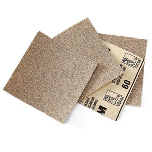

Step 4: Cleaning Up the Print and Using It
After the design is done printing, now you need to clean it. To do this you need to just take the support materials off. Pliers, specifically needle nose pliers tend to be most helpful but you can use your hands too. Another optional choice is to use sandpaper to smooth out the edges but other than that, once the supports are off you should be ready to use it.
