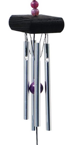

The first challenge was to develop the design for a non-jarring alarm. That eliminated the use of typical buzzers or bells and bright lights that are not always attention-capturing. After much brainstorming, a possible alternative was to use a simple, small wind chime to provide gentle jingling reminders. But, since wind chimes are obviously driven into motion by the wind, a key problem is how to stimulate their motion when activated inside by a timer instead of randomly by the wind.

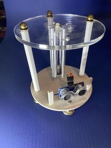

Based on the above design requirements, an initial prototype was constructed. This consisted of a low-cost, small wind chime mounted under a supporting brass rod and a small vibrator motor with a small clapper rod mounted on the shaft to bounce the wind chime. The brass rod was supported by a round plywood platform that had the Arduino, timer module, and ultrasonic sensor underneath.
While it seemed it would be easy to randomly bounce the chime when the motor was turned on, it turned out that it was not regular enough and didn't sound pleasant. Several alternatives were tried, including having the motor on top, using a small servo motor to wag it back/forth, a pulsed stepper motor, and a solenoid pinger.
The most successful was a Rube-Goldberg-like arrangement of a tiny vibrator motor hanging down between the chime bars. When activated the irregular motion caused by the vibrator's rotor "bonked" the chimes more randomly.
This will be used to satisfy Design Requirement 1.

Step 6: Bottom Plate and Final Sculpture Assembly
In the prototyping stages, plywood discs provided the mechanical base of the Habit Reminder Chime. To satisfy Design Requirement 4 for a more attractive appearance, a Base Plate was designed and 3D printed, and a plexiglass disc was added for a top plate to hold the wind chime strands and suspend the motor wiring. These are assembled with the Arduino NANO and associated electronic components mounted under the Base Plate.
The final version is shown in the cover image and here. The goal was to provide a more attractive final implementation to satisfy Design Requirement 4.
