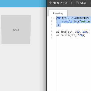

Step 3: Protocoder: Installing App and Importing Hack-A-Lamp Project
Protocoder is a great tool made by Victor Díaz and it's a great tool for app prototyping. It's possible to do great stuff within hours and it works pretty well and fast!
First of all, you must know that protocoder is like a "frontend" to android app developing. The code is written in Javascript and behind that, protocoder handles all android confusing stuff.
It got a full ide, with examples and your projects stored on your phone. You just need to donwload the app from Protocoder site and install it on your phone. Then start the app and check out the IP address shown at screen bottom. Grab that IP and go to your favorite browser and start hacking!
You can download the file projects_Hack-A-Lamp.proto on your smartphone or tablet and, with the help of a file explorer, open it with protocoder.

Step 4: Protocoder Code
Let's digg in Protocoder code.

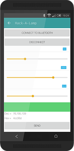

This is going to handle user interface, bluetooth communications, parse color data from sliders to integers and showing color before sending it to Arduino.
First we modify toolbar and screen settings with:
ui.toolbar.title("Hack-A-Lamp ");
ui.toolbar.bgColor(55, 155, 155, 255);
ui.toolbar.show(true);
//ui.screenMode("fullscreen");
ui.screenOrientation("portrait");</p><p>var speed=25;
var btClient;
var sendString= "10,0,0,0",string="0,0,0", hexString="000";
var btStatus = false;
var margin = 10;
var w = ui.screenWidth - 2*margin;
var h = 150;
h is going to be used as height for buttons. If you can't see the text inside buttons, try to fix it modifying this value.

After that, we're going to create cards and slider for each color (RGB). Every code is mostly identical, so i'm going to explain it for just one of them.
First we create a variable with the name of the color, that it's going to store the value readed from slider with:
var red = 0;After that, we create the card that, in this case, it's like a little mark that will show the name of the color. To create them we use:
var cardRed = ui.addCard("Red", margin, 2*h, ui.screenWidth - margin , 100); Then we're going to create the slider: var sliderRed = ui.addSlider(margin, 3*h, w, 20, 0, 255).onChange(function(val) {
red = Math.floor(val);</p><p> string = red +","+ green +","+ blue;
colourDec.setText(string);
hexString = red.toString(16) + green.toString(16) + blue.toString(16);
hexString = hexString.toUpperCase();
colourHex.setText(hexString);
console.log(string);
});The parameters that we need to create a slider are, from left to right in the function: x position, y position, width, height, starting value of the slider and final value of the slider.

At least, we reach to the send function, that handle communications with Arduino. Here is where we transfer data to Arduino through bluetooth.
var btnSend = ui.addButton("Send", margin, 10*h, w, h).onClick(function() {
if (btStatus === true){
ui.jump(btnSend);
console.log("String = "+string);
btClient.send(string +\n");
ui.toast("Sended!");
}else{
ui.toast("¡Not connected!");
});In this code we create a button, just like we did before, and check what value has btStatus stored (Just to remember, if it's connected is going to be true, otherwise is going to be false). In case that btStatus equals true, we perform a little trick to make the button being animated with ui.jump(); function.
Then we show string data in the console, just for debugging proposal, send the string and a line jump (\n) trought bluetooth, so, we are sending: red,green,blue\n which is what Arduino is expecting to recieve.
Then we show an Android toast saying the data is sended.
In case btStatus flag variable equals false (not connected) we're going to send a toast warning about this situation.
