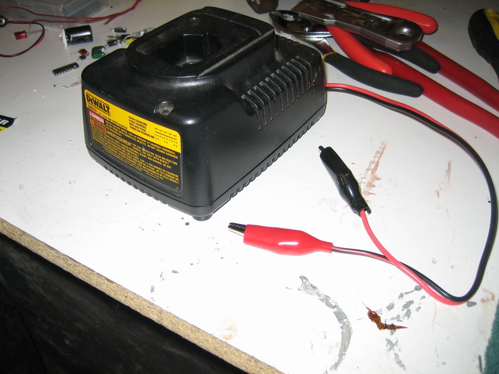

In the future I will add a socket so that I can charge the battery without opening the enclosure for convenience. Also swapping out the 9 volt NiCad batterry for a Lipo would be another big improvement.
