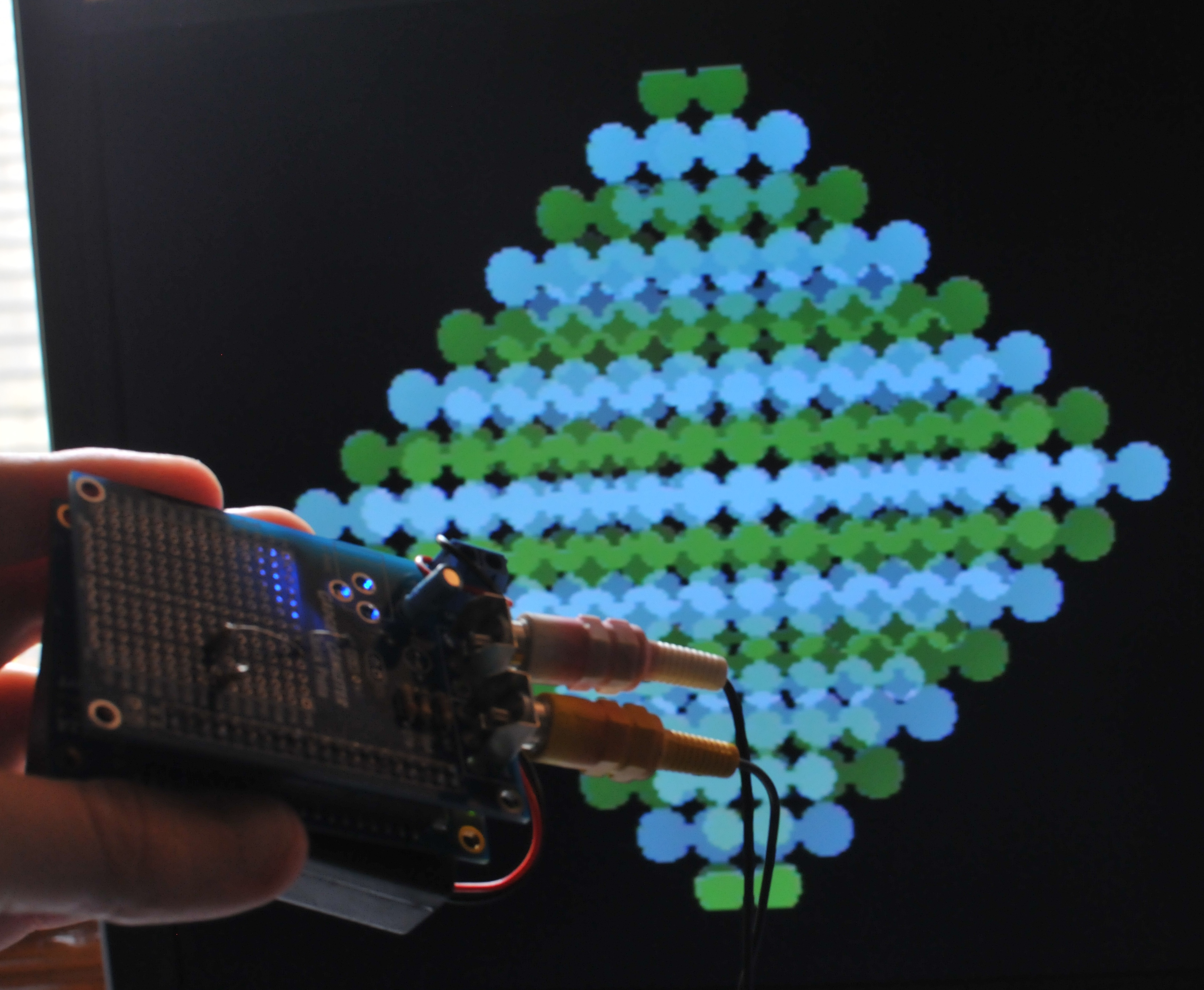

The Car Kracker is a microcontroller with a bit of hardware to talk to your car. It plugs into a connector in the trunk and has several default modes built-in;

Step 2: Make It: Parts
Below are the parts you'll need to build your own Car Kracker - We also offer a kit that includes everything you need right here. The kit also comes pre-programmed and includes a USB cable and mounting hardware.
The kit comes pre-programmed, but if you're building it yourself, you can grab the sourcecode right here. Here's the circuit we're going to build;
Check to make sure you have everything you need, warm up your soldering iron, and continue to the next step
