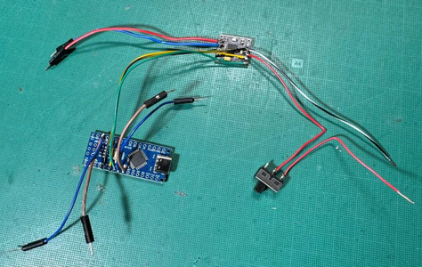

Once you have created the circuit or purchased the kit, you can connect the components necessary for its modification.
The two main elements are the following:
Arduino nano: This is a miniature micro-controller that will be the new brain of the furby. At the same time it will be in charge of communicating the furby with the computer through the usb cable. In this way, it will be able to send the signal when we press on its belly, and at the same time the computer will tell it when it should move. This component is powered through the usb port when connected to the computer
H-bridge driver: This circuit is what allows the micro-controller to control the direction and speed of the motor. This chip is actually ready to control two motors, but it will only be necessary to use one of the two channels. The power to control the motor comes from the 4xAA batteries included in the furby.
Once the two main components for the modification have been presented, I am going to describe which wires need to be connected. This modification is completely reversible, so you can undo it in the future to restore the furry friend's behaviour.
Fortunately, most of the connections are made with connectors, so it is very easy to access the components to make the modification. You just need to be extra cautious when it comes to accessing the batteries, but don't worry, it's all taken care of!
These are the necessary connections from left to right:
1- Pushbutton: This is located on the front, on the belly of the robot. It is a large 4-pin connector, it shares the connector with the speaker.
2-Position sensor: As we are dealing with a single motor to control all the gestures, we must find a way to find out when its eyes are open, closed or even when it should open its mouth. To do this, the system has been simplified by accessing only the position switch on the back of the robot.
3-Motor: This short cable will be connected directly to the motor driver as shown in the picture.
The elements can be attached with double-sided tape or a little hot-melt gun as shown in the images.

Once the components are ready, place the microcontroller on the left side and the h-bridge on the right side. You can use double-sided tape for this, but I recommend a hot melt gun to make sure that none of the parts move.
With the new components added you won't be able to put the black shell back on, but don't worry you will hardly notice the difference.
It is important to keep the wires away from the gears and moving parts, this will prevent it from getting stuck in the future. The switch will be left loose at the back to turn it off and extend the life of our batteries, even though these are only used to move the motor... the Arduino (new brain) is powered through the usb cable when connected to the computer. To be able to make this connection it will be necessary to make a small opening as shown in the image, this way we will be able to access the usb port without any problem.
