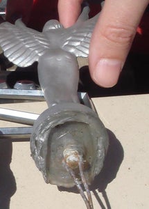

Step 5: Adapt the Trophy-figure Base to the Top of the Hood Fitting.
Obviously, the base of the trophy and the top of the hood fitting aren't matched. On mine, the trophy base is round and ~2" across; the hood fitting is rectangular and smaller. I needed some way to fit the two together so that the figure had a stable base that could deal with vibration and wind on the road. To solve this problem, I used a silicone adhesive to fill in the hollow base of the trophy and essentially mold it to the hood fitting. It's waterproof and flexible, and seems to work well enough so far.
I filled in the base of the trophy figure with silicone adhesive, then slipped the base screw through the hole in the hood fitting, pressed the two pieces together, fixed them in place so that the figure would stand vertical when on the hood, and let the two pieces dry together. This took a day to dry, and probably could have used another 24-48 hours to fully cure. As it was, the hood fitting peeled off, leaving a matching mold on the base of the figure. Not bad.

Next, thread the wire through the hole in the figure's base-screw. Make a loop such that you have two 4" lengths of wire extending down from the base-screw. Then thread the ends of the wire down through the hole in the hood fitting and set the figure upright, matching its base to the hood fitting. It helps to have a friend around to hold the figure upright while you finish the attachment.
Under the hood, fit your spring over the two lengths of wire that extend down out of the bottom of the hood fitting. Mash the spring down tightly and bend the ends of both wires up, fastening the figure tightly down to the hood ornament. You should have a little bit of flex, but not too much; you don't want the hood ornament to be flopping around in the wind on the highway.
