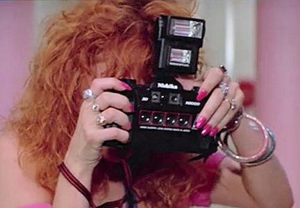

Step 1: Camera Overview -- the Great Pretender
The Nishika N8000 looks like one of those high technology wonder cameras Canon and Nikon were flooding the market with during the 1980's.  However, the closer you look the cheapness and crappiness gets harder to overlook.  Here is my rundown of the more deceptive features of the camera:
1.
  It's big!  Too big in fact.  The camera it replaced, the Nimslo, was half the size with twice the sophistication of this monster.  The huge housing is there just to give the camera some substance.
2.  It's heavy.  Don't blame all that plastic...the real weight comes from a metal chunk in the base of the camera (not lead, but definitely metal).  It's included to give the camera a heavy high tech feel.
3.  That familiar looking pentaprism bump on the top of the camera is not a pentaprism.  It does nothing but holds the hot shoe on the camera.
4.  The hotshoe looks like a high tech wonder with various electrodes that allow the flash and camera to talk and come to logical photographic decisions.  The flash may talk, but the camera isn't listening.  The extra electrodes are just for show and attached to nothing except plastic.
5.  The high tech data display on the top of the camera is not as high tech as it looks.  It does have some useful data, but it is simply printed on plastic that is designed to look like a liquid crystal display.
6.  The exposure system on even the simplest point and shoots will vary the shutter speed and aperture of your camera to get the correct exposure on the film.  The N8000's exposure system is not really connected to the camera in any way.  It is a simple go/no go affair that will shine a red LED in your eye if it thinks there isn't enough light to make a good exposure.
7.  The familiar motor drive bump is there only to hold the 2, AA batteries for the less than useful light meter system.  Your thumb will still be getting a workout while advancing the film.
8.  The variable aperture actually does vary the aperture, but not by too much.  Whereas a modern lens can vary 7 or 8 stop values to adjust to different light values, the N8000 can only muster 2.5 stops.
9.  The 4 plastic lens assemblies are not exactly triumphs of optical engineering.  They vignette badly even at the smallest aperture... even though each lens only has to cover 1/2 a standard 35mm frame.
