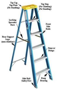

Using a ladder is hazardous. There are several rules that you need to be aware of when using one. I will not cover these rules here but I know, number 1 is safety. Frequently going up and down the ladder can exhaust you easily, so accidents can really happen.

These steps show how to hang a tool holster on the side of the ladder. If you are right-handed, I would suggest to hang it on the right side. If you happen to be ambidextrous, I guess any side you're most comfortable with ;)
1. Extend your A-frame ladder to the maximum.
2. Using your drill driver, drill a hole on one of the front rail and rear rail. Use a level to make sure the holes are level.
3. Screw the hooks and secure with a pair of nuts. I can't find hooks that I can secure with nuts so I used screw eye bolts instead. I just cut-off the ends to use as hooks. A pair of small shelf end-caps should cover the pointy end of the hooks.
4. Hang the tool holster. The tool holster that I have has eyelets for the hooks. It stays in its place even if I close my ladder.
