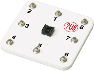

The Snap Circuits Eight-Pin IC Socket block is picture 2 (source: http://cs-sales.net/eiicso6u8.html)
Insert the 555 timer chip into the Snap Circuits Eight-Pin IC Socket block. Make sure that the notch in the top of the 555 timer chip is aligned with the diagram of the chip pictured on the IC socket block. (See picture 3) (Source: http://www.snapcircuits.net/learning_center/designer)
