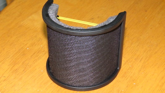

Step 1: Order a Wrap Around Pop Filter
These are available on Ebay for around $3 including postage from China, or if your in a hurry you can pay a little more for one in your own Country.

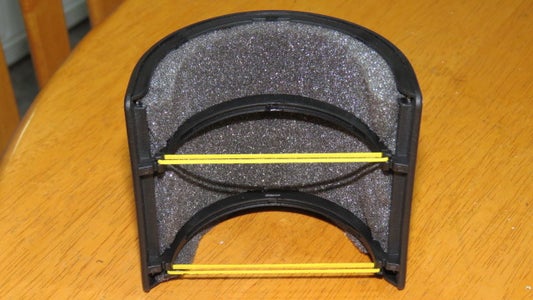

Step 2: Cut the Foam to Correct Length and Width With Scissors
You will need to trim your packing sponge / foam to fit the inside of your Pop filter and insert it. Be careful not to damage the sponge as this will be your noise reducer.
The pop filter comes with two layers of mesh to screen out harsh noises but this alone is not sufficient to reduce home noises down to barely audible and even eliminated altogether.

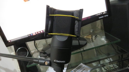

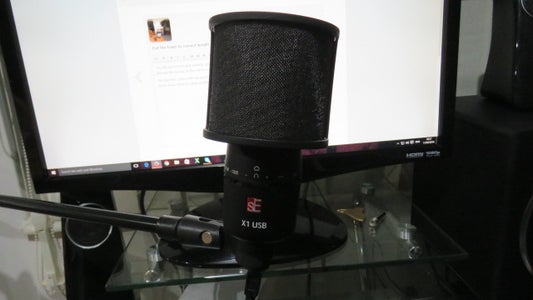

I have a studio microphone and use it for podcasts and radio interviews.
This reflection filter has greatly improved the mic performance by reducing external noises.
