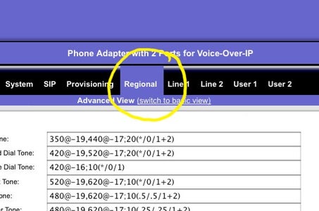

Step 2: Logging On
First thing you have to do connect your PAP2T to your home network, open a web browser to its IP address and log on as a user. Then choose the link to log on as an administrator.
Step 3: Change to Advanced View
Change the view to "Advanced". Otherwise you will not see the settings that have to be changed.
Step 4: Switch to Regional Settings Tab
Switch to the "Regional Settings" tab
Step 5: Optimize Ring Settings
To most reliably and loudly ring a standard metal gong ringer phone, make sure your settings are as follows
Step 6: Gain and Impedance
These are optional, but you may need to adjust them for best quality. Normally set your gains to "0", but if you find it too loud, turn it down to "-3". Set impedance to "600".

We're done configuring, so be sure to click "Save Settings" in the PAP2T web interface. You only have to do it at the end, it is not necessary to do it between tabs. Let the box do its reboot. Now, plug in your phones and try it.
Here's a shot of the back of the PAP2T and the switch. Plug a phone into each line and the ethernet jack into your switch or hub. If you're connecting to the existing house wiring, be sure the line has no connection to any other VOIP adapter or the phone company.
Step 18: Configure Ring
If it worked, you might want to configure your ringdown for a ring different from your regular telephones. Here is where you set it. Basically, switch another ring cadence with Ring1 Cadence. Be sure to click when done.
