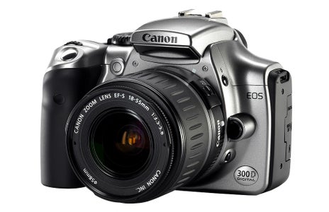

Introduction: Hack a Canon Digital Rebel 300d
This will show you how to turn a regular canon digital rebel into a 10d.
Just with a simple firmware update in under 5 minutes.

Step 3: Get Your New Custom Firmware
you will first need to just plug your CF card into your computer, or in a card reader, Make sure the card is blank, then its as simple as drag and dropping your new custom firmware file to the card.
The file can be obtained by clicking here http://satinfo.narod.ru/en/download.html
Step 4: Insert Card Into Camera
once inserted your camera screen will display something asking if you wish to install, click yes.
Some magic happens, and then if you look for a listing in your menu settings "custom functions" you will have all the tools of the 10d. Bring life into an old camera, It may be outdated but this camera is capable of anything in the right hands. I started with this model and ended up doing photography professionally later in my life.
