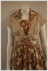

The photo of the linen dress with bolero is one I hoped to use to make a bolero to match my linen dress, but I didn't get around to it. Sigh. Anyhow, you can see that the design is super simple: the collar isn't even a separate piece, it's just cut as part of the bodice, which is lined/faced, and the lining/facing becomes a contrast element. Darts are replaced by gathering at the high waist, the bow hides the single-point closure (probably a hook and eye), and the sleeves look to be set-in, so cut separately.

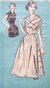

The playsuit / sundress sketch shows a design I love, with the skirt buttoning on the side to the waist (there's probably a zipper from the waist to the armscye, or else a back zipper). Instead of shaping the bodice with darts, the dress has a front yoke that also forms a collar, and the bodice is pleated underneath. There are no waist darts. The skirt looks to be made of six panels.

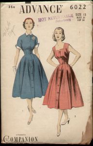

The "advance" pattern shows a very simple dress with no waist seam. I would put one in if I were making this dress, because it's way more economical in terms of fabric use, and I like to belt my dresses anyway, but something cut like this would be very sleek. The dress is probably cut in eight pieces, maybe six: you can see two front centers and two front sides, and the front sides also have an additional dart that crosses the waist. A sketch of the back would enlighten us about the other side, but it's less important; if you want to preserve the same fullness in the skirt, you'll cut four pieces for the back as well. The blue dress appears to be cut in just four pieces, with the sleeves cut as part of the bodice. I like the cute notch detailing on the pink one's neckline: with a facing, you can make the edge any shape you like, pretty much.
