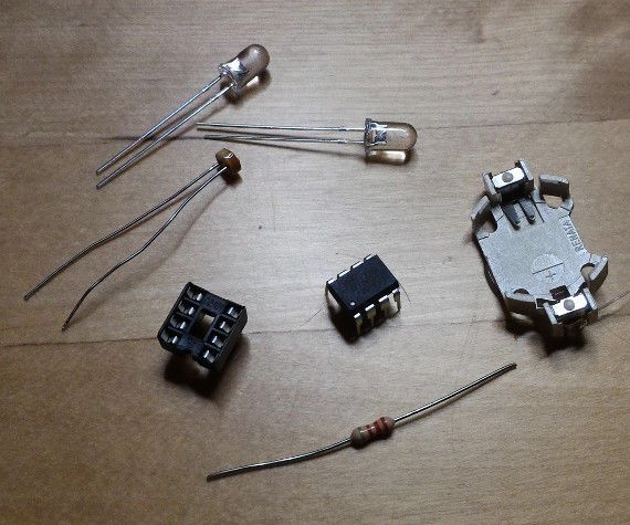

We use a gadget of 2-3 euro's to start the experiment.
A vacuum cleaner (well not really!), test it - if it works, blows, gives a bit of light. (makes noise!)
open it up and get the parts out:
a button/switch
a motor
a LED
a circuit
and the USB cable
With these things and the paper button, we start experimenting.
The motor and the LED are normally running on 3V, the circuit inside the motor has small resistors diminishing the 5V (and the current) if you want to add LED's, be careful and add a resistor of between 300Ohms - 1K, this resistor will protect the LED's.
a button/switch
a motor
a LED
a circuit
and the USB cable

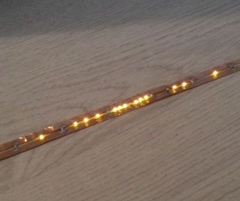

Now the rest is up to your phantasy! Paper, cardboard, or other materials like fabrics can be used for inventing buttons, shapes, situations...
We started making a simple button of paper. (using aluminum foil, glue and electrical wires)
(Using fabric and foil, with a middle layer of neoprene with a hole in it you can make heavier buttons, e.g. for under your shoes)
Then we continued hiding the LED inside a paper folding. The surprise should be not only the light inside the paper, but also the simple text, only lighting up when you push the button. (If you prefer design typography you could think of using the laser cutter to get a good sharp regular balanced text.)
See a switch of "old" newspaper in a later step...

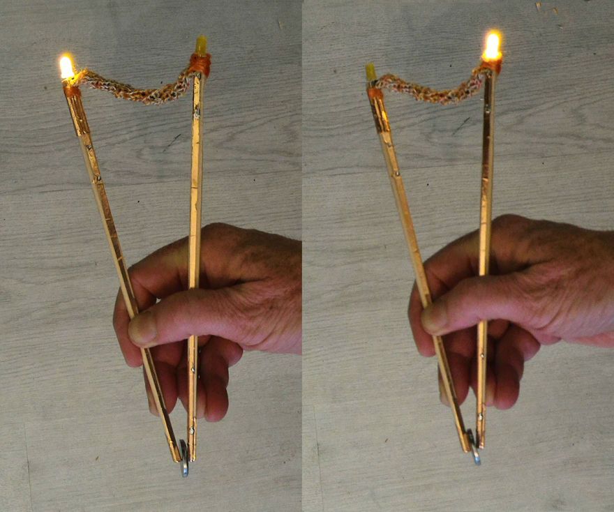

This is a two way button, there are three wires attached.
The button has two positions, up or down. The middle part has a aluminum strip all over, and the upper and lower are small aluminum squares. The wires are at the back side.
The middle one can be connected either to the left or the right wire.
One is connected to the LED's and the other to the motor.
A few seconds video to show the workings:
then you have to imagine a useful way to arrange the LED's....and the VEN part....
the article is about a philosopher, German, kind of difficult to read. (His text are difficult to translate because he is very much "into" the inner workings of the German language, that is why for instance French translations (not to speak of English) loose 50% of the meaning and wordplay.)
