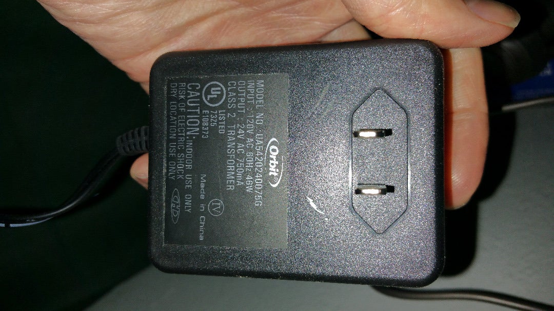

Just connect the thermostat wires as shown above and connect a 24 AC transformer (see next step) to provide the power. The positive lead from the transformer should go to the Rc terminal and the negative should go to the C terminal. In this way, you can trick the Nest into powering itself off of a transformer without putting any unwanted voltage over your thermostat wires.
These types of transformers are commonly available as sprinkler system components at your local hardware store.

Step 1: 24 V AC Transformer
These are commonly available at your hardware store, usually in the sprinkler systems section and will provide the right voltage for your Nest.
I hid mine in the closet behind the wall where the thermostat lives and ran the wires through the wall for a clean setup.
