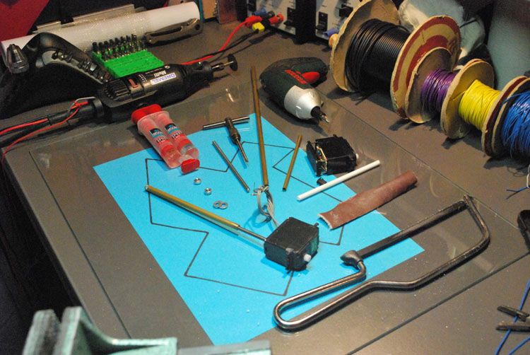

Step 1: Gutting the Servo
Procedure:
- Start by removing the control / power electronics from the servo.
- Remove the feedback potentiometer.
- If continuous rotation is required remove the mechanical stop from the servo’s output gear.
- Disassemble the potentiometer keeping the rotation shaft. This is going to be used as a support shaft for the encoder’s disk magnet. The magnet is going to be glued onto it.
