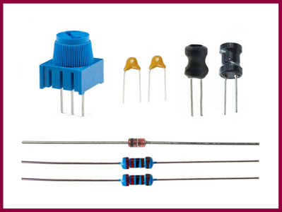

As usual, we'll start with the lowest profile, simplest to solder components...
Resistors
The blue axial resistors have color coded bands for value identification. However, it is always best to confirm the values using an ohmmeter. Resistors can be inserted in either direction.
  • R3: 200K (red black black orange)
  • R5: 20K (red black black red)
  • R6: 300R (orange black black black)
  • R10: 3K (orange black black brown)
  • R11: 150R (brown green black black)
  • R38: 1.5K (brown green black brown)
  • R2, R4: 2M (red black black yellow)
  • R7, R36: 180R (brown grey black black)
  • R28, R40: 470R (yellow violet black black)
  • R37, R39: 10K (brown black black red)
  • R1, R14, R16: 100K (brown black black orange)
  • R8, R12, R13: 120R (brown red black black)
  • R9, R15, R26: 1K (brown black black brown)
Inductors
The three axial inductors look like fat, greenish resistors. They can be inserted in either direction
  • L1, L3, L4: 100uH
Step 5: DSO138 Ceramic Capacitors
Ceramic capacitor values are generally marked in exponential notation for units of picofarads. Recall that "pico" is the metric prefix for 10^-12. 1,000 pF is the same as 1nF. 1,000,000 pF is 1,000nF which is 1uF or 0.001mF.
Some ceramic capacitor marking examples:
  1. The marking "7" is 7 picofarad
  2. "77" is 77 picofarads
  3. "776" is 77[000000] picofarads (or 77uF)
Ceramic capacitors are not polarized. They can be inserted in either direction.
