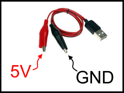

Step 12: USB 5V Alligator Clip Breakout
Pretty much any of the traditional rectangular USB ports (known as USB-A ports) on your computers, or wall chargers, can provide 5V at up to 0.5A for your projects and experiments. Yes, that is only 2.5W, but as you know if you've ever had to feed a Raspberry Pi, traditional USB-style "chargers" are available up to a few amps if you need more.
When using a breakout cable, or any USB module really, be sure to never short power to ground - especially if plugged up to a laptop or other expensive equipment. A powered USB hub can be a great piece of insurance against power shorts.
