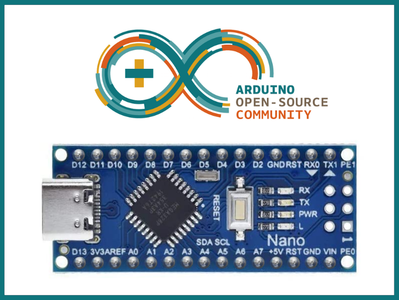

Step 1: Set Up the Arduino Nano
The Arduino Nano is possibly the most common microcontroller (MCU) module currently in use. The Arduino Nano is a surface-mount, breadboard-friendly, miniaturized Arduino board with integrated USB. It is amazingly full-featured and easy to hack. The included variant is based on the ATmega328P MCU operating on 5V at 16Mhz. In includes an on-board USB-C port connected to a CH340 USB/Serial bridge chip.
First Connection
Connect the Arduino Nano into a USB port of your computer. The power LED will come on and shortly after that, a second LED will start to blink slowly. This happens because the Nano is pre-loaded with the BLINK program, which is running on the brand new Arduino Nano.
Software
We will use the Arduino IDE to program and interface with the Arduino Nano.
  1. Download and install the Arduino IDE
  2. Connect the Arduino Nano to a USB port of your computer
  3. Run the Arduino IDE
  4. In the IDE, select Tools > Board > Arduino Nano
  5. Also select Tools > Processor > ATmega328P (Old Bootloader)
  6. Also select Tools > Port > (the USB port connected to the Nano)
USB Troubleshooting
If there are multiple USB ports to select from, you can do a little test. One of the ports will disappear from the list when you unplug the USB cable from the Nano and then navigate back into the Tools dropdown menu again. That one that disappears is the port connected to the Nano.
If there are no USB ports to select (or at least there is no port that disappears when unplugged), you may need to install a driver for the USB chip on the Nano module. This chip is the CH340 which have a driver included in most modern operating systems, but there is more information here if you need it.
Example Code
Load up a piece of example code:
File->Examples->Basics->Blink
Blink is actually the code that was preloaded onto the Nano and should be running right now to slowly blink the onboard LED. Accordingly, if we load this example code, nothing will change. Instead, let's modify the code a little bit.
Looking closely, you can see that the program turns the LED on, waits 1000 milliseconds (one second), turns the LED off, waits another second, and then does it all again - forever.
Modify the code by changing both of the "delay(1000)" statements to "delay(100)". This modification will cause the LED to blink ten times faster, right?
Let's load the modified code into the Nano by clicking the UPLOAD button (the arrow icon) just above your modified code. Watch below the code for the status info: "compiling" and then "uploading". Eventually, the IDE should indicate "Uploading Complete" and your LED should be blinking faster.
If so, congratulations! You have just hacked your first piece of embedded code.
Once your fast-blink version is loaded and running, why not see if you can you change the code again to cause the LED to blink fast twice and then wait a couple of seconds before repeating? Give it a try! How about some other patterns? Once you succeed at visualizing a desired outcome, coding it, and observing it to work as planned, you have taken an enormous step toward becoming a competent hardware hacker.

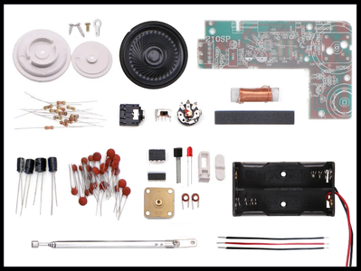

Step 5: AM/FM Receiver Kit Parts
The AM/FM Receiver Kit has quite a few parts starting with a PCB and four semiconductor devices
AM/FM Receiver PCB
IC1 CD9088 (SO-16 F.M. Receiver Chip)
IC2 CD7642 (TO-92 A.M. Receiver Chip)
IC3 TDA2822 (DIP-8 Audio Amplifier Chip)
LED Red 3mm Light Emitting Diode
12 Resistors
R1  1K	  brown, black, red
R2 33K orange, orange, orange
R3 22K red, red, orange
R4 680R blue, gray, brown
R5 1.5K brown,green, red
R6 10K brown, black, orange
R7 22R red, red, black
R8 3.3K orange, orange, red
R9 330R orange, orange, brown
R10 100K brown, black, yellow
R11 4.7R yellow, violet, gold
R12 4.7R yellow, violet, gold
26 Ceramic Capacitors
C1   471
C2 104
C3 202
C4 683
C5 104
C6 104
C7 221
C8 25p
C9 104
C10 82p
C11 5p
C12 331
C13 332
C14 181
C16 104
C17 332
C18 104
C19 202
C20 104
C22 103
C24 104
C26 104
C27 104
C28 104
C29 104
C30 104
4 Electrolytic Capacitors
C15   220uF
C21 10uF
C23 100uF
C25 100uF
Additional Components
L1    7T5 Inductor Coil
L2 8T5 Inductor Coil
CA/B Variable Tuning Capacitor
J1 Headphone Jack
S1 AM/FM Switch
VOL Potentiometer with Switch
Speaker
Battery Holder (2 x AA)
Telescoping FM Antenna
Solder Lug
Three Screws
Two Plastic Dials
AM Radio Coil
Ferrite Rod for AM Coil
Plastic Mount for Ferrite Rod
Three Insulated Jumper Wires
Step 6: AM/FM Receiver Kit Assembly
  • Start by placing the CD9088 (F.M. Receiver Chip) on the back of the PCB. Match the pin one dot on the chip to the pin one indicator notch on the PCB silkscreen.
  • Place the 12 resistors. Be sure to know the value of each resistor before soldering it into place. Measure with a multimeter if necessary. Resistors are not polarized and can be inserted in either direction. Note the PCB silk screen markings that show how some of the resistors are to be flat against the board and some are standing up vertically.
  • Use the trimmed lead from one of the resistors to form the jumper wire J1.
  • Place the 26 Ceramic Capacitors. Carefully confirm the value marking of each capacitor before soldering it into place. Ceramic capacitors are not polarized and can be inserted in either direction.
  • The two small inductors L1 and L2 are very similar but one had 8 turns and one has 7 turns. Hold them against each other to see which is slightly wider by one turn. That is the 8T5 coil and the other is the 7T5 coil. The 5 indicates that they are both about 5mm in diameter. The inductors are not polarized.
  • The four electrolytic capacitors are polarized. They must be inserted in the correct orientation. There is white hatching on the PCB silkscreen to designate the negative side of each electrolytic capacitor. Match this to the white bar showing a "-" marking on the corresponding capacitor. That negative terminal of the capacitor will also have a shorter lead than the positive terminal. Positive terminals of devices are generally indicated by having a longer wire.
  • The positive terminal (anode) of the red LED has a longer lead (surprise, surprise) and should be oriented adjacent to the "+" marking on the PCB silkscreen.
  • The DIP-8 chip and the 3 pin TO-92 chip must both be oriented to match the markings on the PCB silkscreen.
  • The variable capacitor has a wider tab and smaller tab. The smaller tab goes over the edge of PCB, which is the only direction it should easily fit without forcing it in.
  • The volume potentiometer, AM/FM switch, and the headphone jack positioning should be obvious according to the PCB holes and markings.
Step 7: AM/FM Kit Final Assembly and Tuning
Identify the Hardware
  • There are three screws and solder lug.
  • The thicker screw and the solder lug go with the telescoping FM antenna.
  • The shorter screw attaches the larger plastic dial onto the variable tuning capacitor.
  • The longer, skinny screw attaches the smaller plastic dial onto the volume potentiometer.
A.M. Radio Coil
  • Slip the coil over the ferrite rod.
  • Position the plastic mount over one end of the ferrite rod.
  • Press the plastic mount into the notch along the top of the PCB.
  • Feed the leads from the coil through the hole in the PCB just to the left of the switch.
  • Solder the leads onto the two pads marked "AM" on the rear of the PCB.
Speaker
  • Use two jumper wires to connect the speaker to the two pads marked "SP" on the rear of the PCB.
Telescoping F.M. Antenna
  • Use one jumper wire to connect the soldering lug on the antenna to the pad marked "ANT" on the rear of the PCB.
Battery Housing
  • Solder the black lead of the battery housing to the pad marked "-" on the rear of the PCB.
  • Solder the red lead of the battery housing to the pad marked "+" on the rear of the PCB.
Power On
  • Put two AA cells into the battery holder.
  • Turn the volume potentiometer to click the circuit on. The red LED should light up.
  • Turning the capacitor dial to see if you hear any transmission on FM or AM. You probably will not.
FM Tune Up
  • Switch the selector to FM and turn the volume up.
  • Extend the telescoping antenna.
  • Spread out the turns of the 8T5 coil a little bit. This is the little coil next to the big tuning dial.
  • Use a small screwdriver to adjust the FM fine tuning screw on the back of the variable capacitor.
AM Tune Up
  • Use a small screwdriver to adjust the AM fine tuning screw on the back of the variable capacitor.
