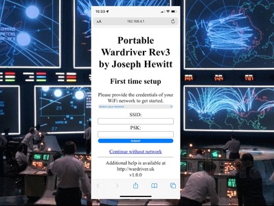

Step 7: Wardriver.UK
Browse over to Joseph Hewitt's wardriver.uk Rev3 repository.
There are five required libraries listed there, but we've already used three of them.
Use Tools > Manage Libraries to search for and install the last two libraries:
- MicroNMEA v2.0.x by Steven Marple
- GParser v1.4.x by AlexGyver
The repo features an A.ino sketch and a B.ino sketch.
As you might guess, these get programmed onto ESP32-A and ESP32-B.
Dig out a 4-16GB MicroSD card and format it as FAT32.
(Larger capacity cards are not recommended and may be unsupported.)
As discussed under Advanced Config:
Make a file on the SD card named: cfg.txt
Put this text in the file: sb_bw16=yes
Insert the card into the Wispier's MicroSD slot.
Apply power to either of the ESP32 USB-C ports.
Watch the magic!

Step 9: JavaScript Object Notation
JSON (JavaScript Object Notation) is an open standard file format and data interchange format that uses human-readable text to store and transmit data objects consisting of name–value pairs and arrays (or other serializable values). It is a commonly used data format with diverse application in electronic data interchange, including that of web applications with servers. JSON is a language-independent data format. It was derived from JavaScript, but many modern programming languages include code to generate and parse JSON-format data. (Wikipedia)
"It seems like the plot from some bad hacker movie. But it wasn’t."
Step 10: Go Forth and Wardrive
