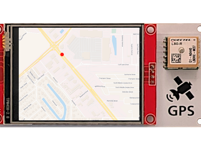

Step 4: Thrifty Yeti Locator
If you like the CYD (as featured in HackerBox 0099), you might just love the TYL. Much like the Cheap Yellow Display, the Thrifty Yeti Locator includes an ESP32, color touch display, and an SD card slot. Unlike the CYD, the TYL also includes a GPS module - useful for locating Yetis, Swamp Apes, Bigfoot, Sasquatch, Wookiees, Skunk Apes, and much, much more!
To maximize compatibility, the TYL uses the same 240x320 pixel display, ILI9341 display driver chip, and XPT2046 resistive touch controller as the ESP32-2432S028R CYD, which was the CYD version featured in HackerBox 0099. The TYL also uses the same I/O pin mappings as the CYD, which are listed here:
TFT_MISO 12
TFT_MOSI 13
TFT_SCLK 14
TFT_CS 15
TFT_DC 2
TFT_RST -1 (tied to 3.3V on TYL)
TFT_BL 21
TOUCH_IRQ 36
TOUCH_MOSI (DIN) 32
TOUCH_MISO (DOUT) 39
TOUCH_CLK 25
TOUCH_CS 33
SD_MISO 19
SD_MOSI 23
SD_SCK 18
SD_CS 5
Accordingly, CYD projects should run on the TYL without modification.
The additional GPS module on the TYL is mapped to the following ESP32 I/O pins:
GPS_RX 1
GPS_TX 3
The TYL also routes these I/O and power nets to a twelve pin expansion header:
3V3, GND, 22, 34, 35, 26, 17, 27, 16, 4, 0, 5V
Assembling the TYL
Start by identifying the header pins. There is a 14 pin header in the plastic box with the TFT Display. Do not snap this header. It goes to the longer (14 pin) connector of the display module. There is a 16+ pin header in the zipper bag with the GPS module and SD Card adapter. Snap 4 pins from one end of this header for use in the smaller (4 pin) connector of the display module. The remainder of this header may optionally be populated into the expansion connection on the edge of the TYL PCB.
  1. Match the small WHITE ARROW on the back side of the L80-R GPS Module to the pad with the SMALL BLACK arrow on the TYL PCB. This should result in the GPS module being oriented as shown in the image above.
  2. Solder the pads of the GPS Module. If you are new to soldering castellated modules, review this SparkFun tutorial.
  3. Solder the two display module headers (14 pin and 4 pin as discussed above) onto the back of the display module.
  4. Position the display module onto the TYL PCB. Attempt to keep the red PCB and the white PCB as parallel as possible. Solder the 14+4 display module pins onto the white TYL PCB.
  5. Pop the ESP-WROOM-32 Development Board onto the TYL PCB with orientation as indicated. Solder the pins of the ESP32 module onto the white TYL PCB.

Step 5: TYL Mapping
You'll need three files attached to this Step.
  1. Arduino sketch: TYL_GPS_Map.ino
  2. US.bmp (right click and save the image above)
  3. GulfGate.bmp (right click and save the image above)
Format an SD Card with FAT32 and copy the two map files onto the root of the card. At least copy the US.bmp map file. GulfGate is a village area not far from HackerBoxes HQ where we often go for lunch, so we wanted to test this firmware there. The GulfGate.bmp file map will never open unless you happen to be driving through Sarasota, FL, so it is probably safe to ignore it.
Open the TYL_GPS_Map.ino sketch in the Arduino IDE.
Follow the note at the top of the sketch about the additional library to load into the Arduino IDE - Adafruit ImageReader Library (with dependancies). It can be searched and installed used the IDE's Library Manager.
Compile and upload the sketch to the TYL.
Once the GPS Satellites are Acquired, the TYL will display a map of the US with a blinking red dot on your location.
This assumes, of course, that you are located in the mainland US.
