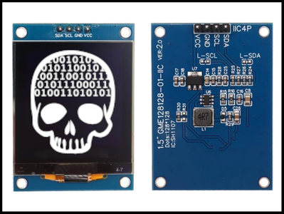

Step 2: 128x128 OLED Display Module
As presented in a very helpful tutorial, this 1.5 inch 128×128 pixel OLED display module uses the SH1107 driver chip. The display module features an I2C communication interface for ease of use with ESP32, RP2040, nRF52m, or AVR Arduino microcontrollers.
