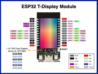

Step 3: ESP32 T-Display Module
To build confidence, configure the required tools, and reduce troubleshooting variables, we will initially be working with the T-Display Module WITHOUT SOLDERING the pins (or anything else) to the module.
The microcontroller (brains) and graphical display for the HackerBox Fox Hunt Kit is provided by the LilyGO TTGO ESP32 T-Display Module, which we will refer to as the T-Display. It's a very compact ESP32 development board with a built-in 1.14 inch IPS 240x135 Full-Color Display. The T-Display module also provides Wi-Fi, Bluetooth, a battery charging interface, two onboard GPIO buttons, and a USB-C connector. The IPS Color Display is controlled by an ST7789V Driver Chip that is prewired to the ESP32 pins shown in the diagram above.
Let's roll...
  1. Power up the T-Display using a USB-C cable
  2. The factory programmed firmware will display a graphics demo
  3. Install the Arduino IDE (if you don't already have it)
  4. In the IDE, use the Boards Manager to search for ESP32 (by Espressif Systems)
  5. Select that board package and hit install
  6. Under the Tools menu, select:
  7. Board: ESP32 Dev Module
  8. Upload Speed: 921600
  9. CPU Frequency: 240Mhz (WiFi/BT)
  10. Flash Frequency: 80Mhz
  11. Flash Mode: QIO
  12. Flash Size: 4MB (32Mb)
  13. Partition Scheme: Default 4MB with spiffs (1.2MB APP/1.5 SPIFFS)
  14. Core Debug Level: None
  15. PSRAM: Disabled
  16. Port: COM port that appears and disappears when T-Display is connected/disconnected
  17. Upload Speed: 115200 (setting this lower speed can help with programming the MCU)
  18. From Tools > Library Manager, search for and install the "Adafruit ST7735 and ST7789" Library
  19. When asked to include all dependencies, elect to do so
  20. Grab the attached graphicstest_T_Display.ino sketch
  21. It's a slightly modified example file from the Adafruit ST77xx Library
  22. Compile and Upload the sketch to the ESP32 of the T-Display module
