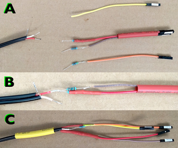

Using a couple of RCA pigtails, three resistors, and some heat shrink tubing, we can make a composite video (with audio) cable to use with almost any microcontroller platform. It can be very useful to "connectorize" modules, devices, and cables by soldering half of a Dupont cable onto each terminal. You can finish each connection with a very narrow piece of shrink tubing and then finish the entire thing with one larger piece of tubing. It looks very neat and provides for a strain relief.
For the cable in the pictures, a label was printed with the signal names (use about 6 point font) and cut with an exacto knife to label each tiny Dupont connector. If you use female connectors you can gender-bend them with a pin from a SIP header (or a piece of hookup wire) to create a connector that works on F or M interface blocks.
Once the cable is made, test out the video output using the TVout Arduino Library.
