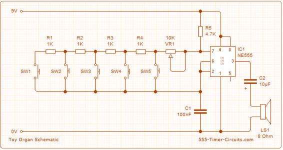

Step 9: Five-Key Toy Organ
This project demonstrates building a simple five-key toy organ using the 555 Timer Chip. Here are some more examples of this circuit including videos.
