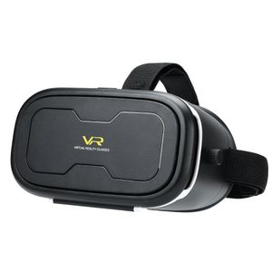

Step 3: VR Headgear for Smartphones

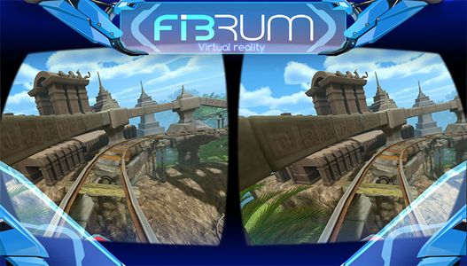

Google Cardboard introduced the world to easily-accessible, low-cost virtual reality by leveraging smartphone technology for processing and display. A simple mobile application is launched on the smartphone and then the smartphone is simply placed into the viewer (also known as the headset).
The smartphone display is split into left and right stereoscopic components. When viewed through the lenses of the headset, the two images are fused into one image with depth for three-dimensional effect.
While Google Cardboard was named for the original fold-out cardboard viewers supplied by Google and others, applicable headsets are no longer limited to those made of cardboard. The nicer plastic variety, such as those seen here, work the same way, but are much more durable and comfortable to use.
Install the Google Cardboard mobile application on your smartphone and give it a try. If your smartphone is running Android, some applications may be controlled by the Bluetooth Gamepad Controller.

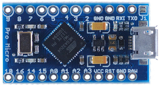

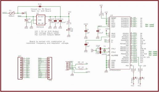

Step 6: Arduino Pro Micro 5V/16MHz
The Arduino Pro Micro is based on the ATmega32U4 microcontroller which has a builtin USB interface. This means that there is no FTDI, PL2303, CH340, or any other chip acting as an intermediary between your computer and the Arduino microcontroller.
We suggest first working with the Pro Micro without soldering the pins into place. You can perform the basic configuration and testing without using the header pins. Also, delaying soldering on the module gives one less variable to debug should you run into any complications.
If you do not have the Arduino IDE installed on your computer, start by getting it form arduino.cc. WARNING: Be sure to select the 5V version under tools > processor prior to programming the Pro Micro. Having this set for 3.3V will work once and then the device will appear to not ever connect to your PC until you follow the "Reset to Bootloader" instructions in the guide discussed below, which can be a little tricky.
Sparkfun has a great Pro Micro Hookup Guide. The Hookup Guide has a detailed overview of the Pro Micro board and then a section for "Installing: Windows" and a section for "Installing: Mac & Linux." Follow the directions in the appropriate version of those installation instructions in order to get your Arduino IDE configured to support the Pro Micro.
We usually start working with an Arduino board by loading and/or modifying the standard Blink sketch. However, the Pro Micro does not include the usual LED on pin 13. Luckily, we can control the RX/TX LEDs and Sparkfun has provided a neat little sketch to demonstrate how. This is in the section of the Hookup Guide entitled, "Example 1: Blinkies!" Verify that you can compile and download this Blinkies! example before moving on.

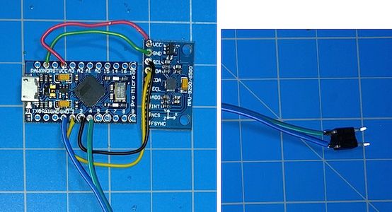

The Inertial Measurement Unit (IMU) is based on a MPU-9250. The MPU-9250 is a second generation 9-axis MotionTracking device comprising a 3-Axis Gyroscope, 3-Axis Accelerometer, and a 3-Axis Magnetometer.

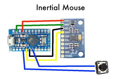

The schematic shown here demonstrates how to wire up the Arduino Pro Micro and the MPU-9250 to create an Inertial Mouse. One mouse button is also added.
This project (with video) includes an Arduino library for the MPU-9250 and also has some example code to start with for our inertial mouse:
- copy the code as shown
- remove (comment out) all reference to the right button
- change the left button pin to pin 4 (or whichever pin you used)
- change pinMode for leftbutton from OUTPUT to INPUT_PULLUP
- reverse the active level for leftstate
As wired here (as opposed to in the example code), the button signal is active low since it is pulled up when released and grounded when the button is pressed.
if (leftstate == LOW) { //grounded when pressed
Serial.print(" Left Click! ");
Mouse.press(MOUSE_LEFT);
if (leftstate == HIGH) { //pulled up when not pressed
Mouse.release(MOUSE_LEFT);

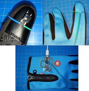

Step 8: Virtual Reality Glove
Once you test out the Inertial Mouse, you can mount it to the Prototyping PCB (optional) or to a piece of cardboard (optional) and then use the provided velcro tabs to adhere it to the back of a glove. The "mouse button" can be affixed to a fingertip using hot glue (or epoxy) so that it can be pressed using the thumb while operating the Inertial Mouse.

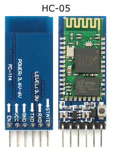

Step 9: HC-05 Bluetooth Module
The Bluetooth Module (HC-05) can easily be used in place of the serial monitor interface. For example, get any sketch running on the Arduino that uses serial communications. Do not wire up the HC-05 Bluetooth module yet. From the start, set the data rate to 9600bps. That is the default for the HC-05 so this just makes it easier to transition later.
Get the program running on the Arduino and working with the serial monitor on your computer (make sure to set the computer serial rate to 9600 as well or it will not work). Now you can disconnect the computer (or just turn the IDE and serial monitor off if you still need it for power) and wire up the HC-05. Now Bluetooth is taking the place of the serial monitor. Sync your mobile device's Bluetooth radio to the HC-05 and run an app like BlueTerm on the mobile device. This will let you type to the serial port from the mobile device just as you did from the Arduino serial monitor, but this time, you are wireless.
As an advanced option, if you want to be able to leave pins 0 and 1 connected to the PC (via the USB interface), you can modify whatever sketch you are working with to use the SoftwareSerial and wire the HC-05 rx and tx lines onto two other pins.
