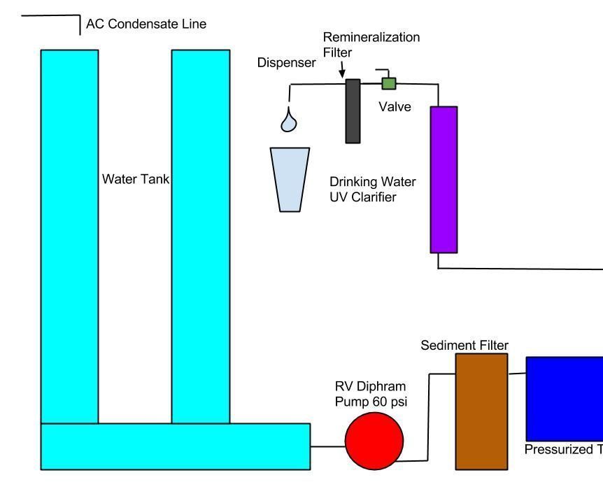

Step 3: Freshwater Module
Freshwater Module
AC condenser - Air conditioning condensate is collected in a tank from atmosphere inside the habitat
Tank - Our tank is constructed with two 5 foot 4" diameter pipes that were connected and serve as the collection tank
RV Diaphragm Pump - This pump pressurizes the system to 60 psi.
Sediment Filters - This filters out any dust that washed off of the AC condenser and other micro particulate suspensions in the water.
Pressure Tank - Pressure tanks help to elongate the pumps lifespan because they allow them to run when they are needed without continuous running requirements for power management efficiency. Pressure tanks will also reduce water hammer instances helping to keep the water in the lines at a constant pressure.
UV Cleansing - Once past the filter and tank water passes through the UV disinfection unit where 99.9999% of bacteria, viruses, etc are killed.
Re-mineralization - Once the valve is opened pressurized water is pushed through a mineralization pump and into the drinking vessel. Re-mineralization is necessary to maintain the proper proportion of minerals, salts and pH in your body and maintain health.
Piping - Pipes are copper for its natural antibiotic properties.
More detailed instructions can be found here.
