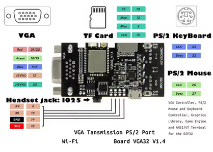

Unfortunately this means I couldn’t use an old dos pc with an MDA card to drive it. But then I remembered I had a TTGO VGA32. This little ESP32 variant provides a perfect VGA signal with the Fabgl library and supports a bunch of cool emulators, games and other applications as library examples. If only I could use it for TTL video, this would be perfect! The Sync pins of VGA are already TTL, I just had to worry about video.
So I found the schematic for the board online and discovered the analog video was created using a resistor ladder method. 2 gpio pins per colour (R,G, &B) going through resistors which then go to a single colour pin out. I desoldered the resistors and removed them (desolder) for one colour. Red I then ran a wire from that pin to one of the free gpio pins on the header (gpio 12).

So now this is where I brought in my friends Chat GPT and Claude. I didn’t know how to calculate CRT timing values so I used the tools. Making measurements with the scope, and entering the values. Trying one thing after another, I came down to the values that would generate at least the proper sync frequencies. Before hooking anything up, I made sure I had sync frequencies that exactly matched the original board. Then I felt confident to connect to the CRT. Although the original board was true 5v TTL, the VGA32 supplies 3.3v output. This turned out to be no problem. The threshold of high state must be around 2v or so.

VGA.begin(GPIO_NUM_12, GPIO_NUM_12, GPIO_NUM_12, GPIO_NUM_32, GPIO_NUM_15);
VGA.setResolution("\"BROTHER\" 14.31818 720 736 776 880 240 243 246 270 +HSync +VSync");
