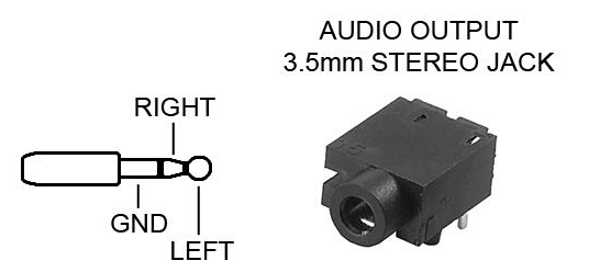

First, locate the audio output connector on your TV. From my experience, more analog TVs have one, but if yours doesn't, you should probably buy and install oneself. Look here if you do. As the name implies, this connector is intended for audio output, usually to a pair of headphones. For this project, we want a signal for the input amplifier. To do this, you first need to disconnect the circuit connector. Use a metal saw or dremel tool to cut the remains going to the socket. Make sure they are completely disconnected. You really don't want the TV trying to send signals on your iPod.
The audio jack has three connection points. On the front of the cat (closest to the outside of the TV) is for the land. On the back of the jack is for audio signal. The remaining connection is used to turn off the external sound when the audio jack is in use. Cut the traces "fools" the TV in the thought that the cat is in use. To solve this problem, weld the traces that went to the second and third connector together. The third photo above should make this clearer.
Now, place the volume control on your TV. It is probably a sphere that turns a potentiometer in the circuit. If so, solder a cable from the signal of the audio connection to the central leg of the potentiometer. Solder the other cable to the ground leg of the audio jack. Plug your music player into the socket and start playing a song. Touch the ground wire to each of the remaining legs of the potentiometer. When you listen to music playing through the TV speakers, you know you have found one. Unplug everything and solder the end of the cable in place. Now that you finished modifying the circuit board.
The only thing left to do is connect the TV speaker to the horizontal deflection coil. Welding two wires in place and close everything. The conversion is complete!
