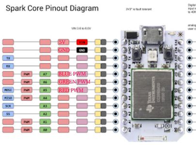

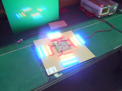

These LEDs runs on 12V DC power and on the main board it has a voltage regulator that supply 5V to logic level - to any microcontrollers that uses 5V. The lights then communicate to the microcontroller -- in our case, a Spark, using three PWM pins.
In our example, we will use the 5V, ground, Red PWM wire, Green PWM wire, Blue PWM wire to Sparks adaptor board and then we will use a 3D printed piece to hold our new Spark adaptor board in place on top of the light.

blue wires goes from 11J to 3I , it's connected to Pin A7 on Spark
green wire goes from 10I to 3H, it's connected to Pin A6 on Spark
red wire goes from 9H to 1F, it's connected to Pin A5 on Spark
grey wire goes to the + line on the perf board , it's connected to VIN on Spark
black wire goes to the - line on the perf board, it's connected to GND on Spark
