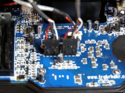

At this point, it's a simple matter to insert the headers into the holes on the mainboard, and solder them in. Good solder joints are smooth and shiny like these. Ensure that none of them are soldered to their neighbor (solder bridge).
Step 18: Installing the Jumper Pins on the Mainboard (continued)

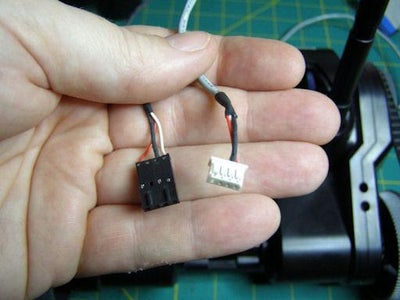

So you ask, "I have pins, now what do I use for plugs?" You can order connectors online to fit the headers, although Sparkfun doesn't carry any. I did some scrounging in my parts box and found that various cables from old computers will connect to the headers. The connector on the left is an audio connector used to hook CDROM drives to sound cards or motherboards. It fits the GPIO spacing. The connector on the right is the type used for internal audio connections, like video capture cards to sound cards, etc. This will fit the JTAG spacing.
Step 20: Installing the Jumper Pins on the Mainboard (continued)
I'm not saying these connectors will meet all your needs, but it at least you can modify them, and it gives you an idea of what to look for in your junk box. In the pic below, I have two CDROM audio cables on the GPIO...this would give me A-to-D and five GPIO connections; certainly enough to play around with. Other .1" connectors from an old computer case or motherboard (e.g. front panel switches, USB headers, chassis fans) should be of compatible spacing as well.

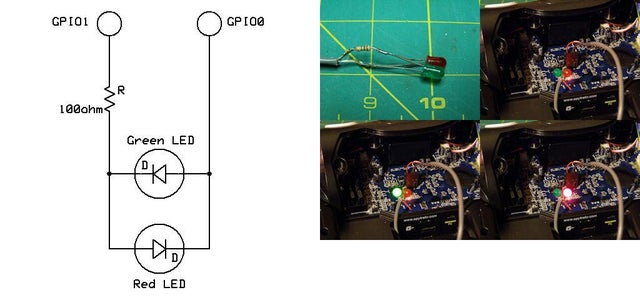

Step 21: Use the GPIO Pins to Flash LEDs (Light Emitting Diodes)
The test to control a device using the GPIO connections is to switch LEDs on and off by pressing buttons on the TRAKR remote. I used one of the CDROM audio cables that I mentioned above. I wired the components directly to the cable; I didn't really think it was worth a circuit board. The 100ohm resistor drops the voltage to 1.6...perfect for the LEDs.
You can see how it was soldered in the upper left portion of the picture. When you run the trakrmotorcontrol app and no button is pressed, nothing illuminates. When button A is pressed, the green LED lights up; when button B is pressed, the red LED lights up.

When you compile the above code with the above make file, this will create a Trakr App file called "trakrmotorcontrol.bin" and the file will need to be copied to the Trakr. Make sure the Trakr is switched off and connect it to your computer using the yellow USB cable that came with the Trakr. Copy trakrmotorcontrol.bin to the APPS folder inside the Trakr folder. Disconnect the Trakr from your computer and switch the Trakr on. Switch the Trakr remote on, click the home button, and select trakrmotorcontrol from the menu.
You can use the trakrmotorcontrol app to control many different types of electrical devices...motors, lights, relays, etc.
