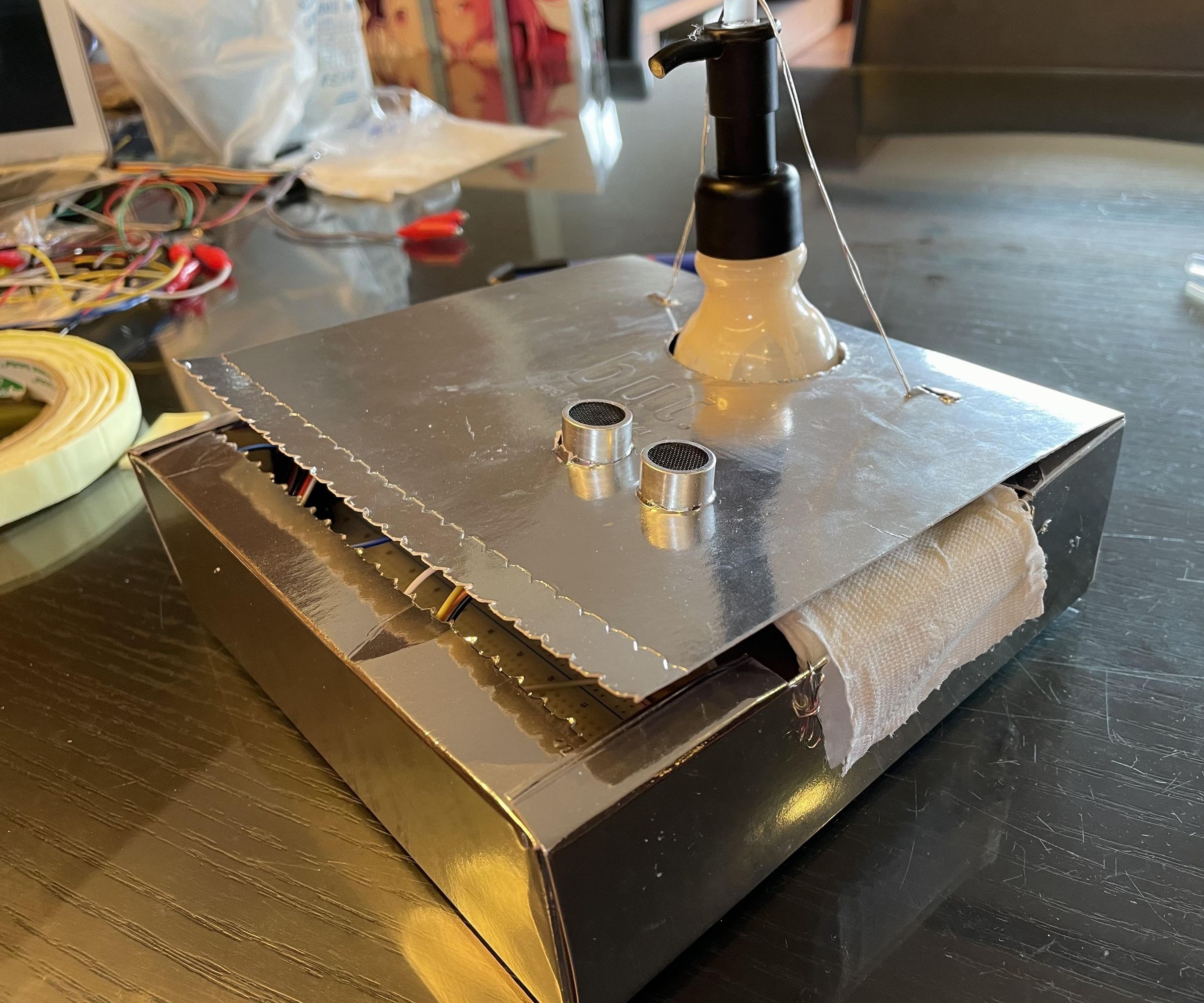

Step 4: Step 4: Shoe Box
Cut a 5.5 radius circle anywhere on the box with the unify knife. (But do not cut it completely, leave it where you can open it)
Then cut another rectangle 4.5 x 9 cm, and cut the same size of transparent paper.
Step 5: Step 5: FINSIH!
https://youtu.be/pkGFnAIJ8Hk-----> Youtube Link
