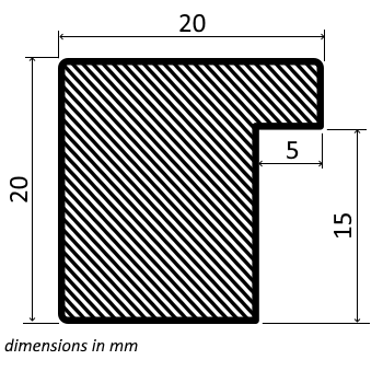

I ordered the wooden frame online from a company that are specialized in photo framing, and other framing accessories. The dimensions of the frame section are those in the figure below.
As always, although I specified in the order the internal size I wanted (as close as possible to 200mm), the frame that was delivered to me had an internal size of about 204mmx203mm, that's why I needed some 1.5 - 1.6 mm thick plates to lock the grid.

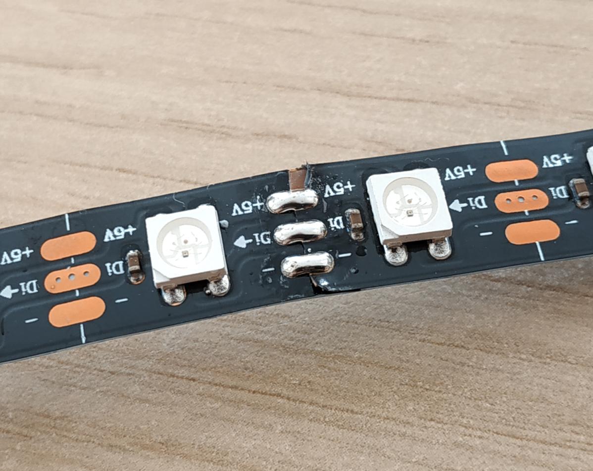

After printing on the 3D printer the LED support and the LEDs separation grid, I moved on to perhaps the most important phase of the construction: fixing the pieces of LED strip to the support. I started by cutting the necessary lengths from the LED strip, there are the longest pieces that contains 14 LEDs and the shortest one with two LEDs. Then, I unfolded the protective paper of the self-adhesive support in the middle of the strip and I fixed the middle piece with some LEDs, taking care to match the position of the LEDs as well as possible with the guide lines on the support. Gradually, I removed the protective paper to the edges of the pieces of strip and at the same time I fixed the LED strip carefully. When I was close to the ends, I completely removed the protective paper, folded the ends of the strip and inserted them into the slots in the support. I thus fixed the pieces of LED strip from layer I (blue color) then layer II (green color) according to the figure (see also photos above).
Tip: Avoid having soldered parts like this
in the LED strip pieces as much as possible. In the case of such soldering, the distance between the LEDs is never the required one. In my case, it should be 1000/60 = 16.667mm (60 leds/m). Many times, even in the factory, this distance is not respected, I had 60 leds/m strips where the distance between the LEDs was 16.4 - 16.2 mm, over long distances (many LEDs) this error accumulates progressively. It is useful to measure the strip you are working with before, ie to measure if the distance between the LEDs is correct and choose a strip accordingly.
Also be very careful when orienting the LED strips, Data OUT (DO) always connects to Data IN (DI).
