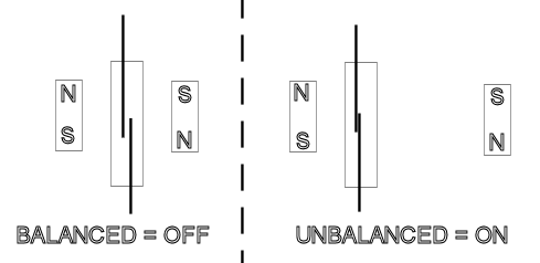

A latching hall effect switch turns ON when it sees one pole of a magnet.
Pull the magnet away and it stays ON.
When it sees the other pole of the magnet, it turns OFF.
And stays OFF untill it sees the first pole again.

A normal (momentary) switch would give a short blip as the magnet goes by.
But a latch would give a nice square wave as the alternating magnet poles go by.
