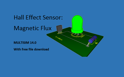

Build a magnetic switch using a Hall Effect sensor in Multisim. 5 to 10 minute newbie special!
