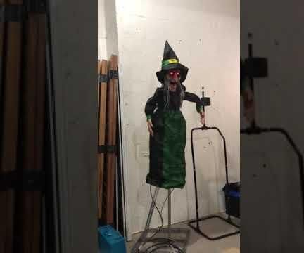

- A Witch that is hidden in a window well that I fill with fog that pneumatically pops up, speaks with a moving jaw and glowing eyes.

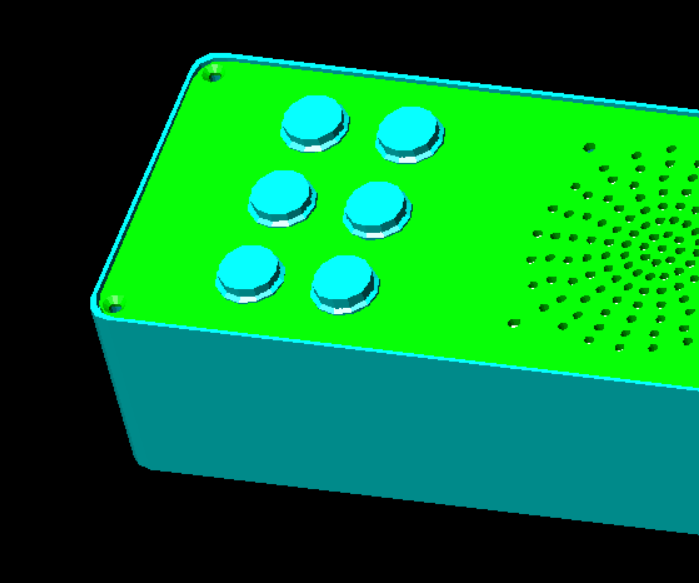

I needed a way to mount the speaker so I removed the speaker from the original prop and 3D printed a case and using some 3D printed clamps attached it to the original frame. The enclosure has a hole to allow the speaker wires to exit and I placed connectors at the end so that I have an easy way to disconnect from the electronics board.
