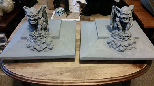

Step 4: Column Caps
The first thing to do for the column cap is to address the gargoyles (How do you do, gargoyles?). The good thing about these particular gargoyles besides the price ($9.99 each!) is that they are hollow. The bottom is covered with paper, so just tear that off. Then use a drill to put a 1/4" hole where each gargoyle's mouth is. Then I fed the tubing from the inside of the gargoyle to the mouth and jammed a 1/4" dowel through the outside of the gargoyles mouth into the tube. If you don't have a dowel lying around, you can use pretty much anything that is round and makes a tight seal on the inside of the hose. The dowels will hold the tube in place temporarily and make sure that the tube doesn't get clogged. Leave a couple inches of the tubing sticking out from the bottom of the gargoyles for the time being. Now use the expanding foam to fill the gargoyles. Remember that this stuff expands a lot, so fill it only about halfway full.
Once the foam has fully cured, trim off the excess coming out the bottom with a saw. Hopefully, you don't have any coming out of the mouth, but if you do, do your best to break it off with your fingers and any other implements of destruction. At this point you can also cut the tubing flush to the bottom and remove the dowel from the gargoyle's mouth. Make sure that the inside of the tubing is clear of foam all the way from the bottom to the mouth. If it isn't, use some wire or a bottle brush to clear it out as best you can. It doesn't have to be perfect just make sure air can get all the way through the tube easily. Finally, I attached a 1/2" coupling at the end of the tubing. Because the outer diameter of the tubing was a little over 1/2" and the foam squishes a bit, I was able to just fiction fit the coupling.
For the base of the column caps I cut pieces of plywood that were flush with outside edge of the foam at the top of the column. I my case that was roughly 12" x 12". Then, find the center of the plywood by using a straight edge to draw lines to opposite corners. Use this center marking as the location to screw down the pipe flanges that will receive the pipes for the archway. Put the gargoyles in front of the flange and figure out where the coupling is on the plywood. Once you figure that out, drill a hole in the plywood that is big enough for 1/2" PVC pipe to come through. Since these are going to be unlikely to match for both gargoyles, you should either mark the gargoyles and plywood, or at least keep them together.
I then used 2" and 1" foam to create the pieces to make the end cap. Probably looking at the pictures is better than any description I could give you for this. Since the gargoyles went in front of the arch supports and they stuck out a little from the top. I crumbled up some scrap foam to make some rocks to extend their perch out. Depending on your dimensions, you might not need to do this. I also two holes in the foam to line up with the pipe flange and the pipe going into the gargoyle. Once you have all the pieces, use your adhesive to glue the gargoyles, foam, and plywood together to make a complete cap (minus the back). The back piece of the cap will actually be glued to the back column wall you put together earlier. This will allow you access into the column even after the archway has been put in place. You can see in the pictures where I used nails to hold the pieces together while the adhesive was curing. Once again, if you have any gaps you can fill them in with the Apoxie Sculpt.
After all the adhesive and Apoxie Sculpt has cured, do the same paint treatment you did on the rest of the column.

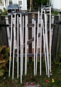

Step 7: Creating the Gate
To get the width of the gate, I set up the columns with the arch dropped into the pipe flanges. It's very important to have the gate and arch be the right width for each other. Starting in on the gate. I took a 4" PVC pipe and sliced it up like a salami with my miter saw to make the rings (width measured to be the same as the rails). I cut strips of luan plywood to make the outer layers of the rails. Four were the same length and the other two somewhat shorter (to accommodate the bottom of the columns where they were thicker). I took a couple of scrap pieces of 1/2" PVC pipe to determine the placement of the pickets. There was a little space left over which I left in the middle. Then I cut a bunch of pieces of wood to space the pickets the same width as the 4" PVC (note... nominal width, if you do this, be sure to actually measure the outside diameter). I was originally going to get some plastic finials, but then was able to find some real cast iron ones for even cheaper (score!). As an added bonus, the finals were sized pretty well to fit inside the 1/2" PVC.
I laminated the luan with the spacer pieces of wood together to make the rails. The holes are sized to fit the 1/2" PVC. You can see in the pictures where I made up the difference in the center (I figure that will look like where the gate was meant to open).
I stuck the finials into the 1/2" PVC pickets with some Apoxie Sculpt. I used some duct tape to temporarily hold the pickets and finials together until the epoxy set. Note that I cut the 1/2" PVC to different lengths to create an arch.
Once the epoxy had set, I fed the pickets into the the rails and drove a screw though the luan into the PVC to hold it together. When the gate was assembled, I set it onto the L brackets from the columns. I marked where the outermost holes in the L brackets lined up on the gate, and then drilled holes in the gate so that I could join the gate to the columns with nuts and bolts.
To finish the gate, I used the same rusting technique I described earlier, where I applied a coat of rust color paint, allowed that to dry, then spritzed the gate with water, and finally gave the gate a coating of black spray paint before the water could dry.
You can use the same techniques to create a fence on either side of the gate, but given my yard configuration I decided that wasn't necessary.
