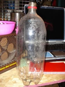

Step 2:
CAREFULLY, cut the top of the bottle off, just below the threads. Next, using the Dremel tool, cut the bottom following the contours of the bottle.
