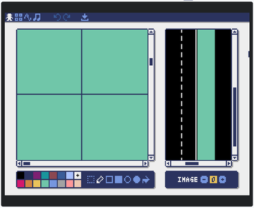

So we have, like indicated in the first image by an arrow, we have the button to go into the coding place. We have, in the second image the place to draw with pyxel. And a little user guide in the third image, we can see at first in this user guide the number corresponding of each color that we need for some function as we have seen before.
And also It is important to understand that on the screen, like we can see in the fourth image, the origin of the reference frame is on top left of the screen, not on the middle.

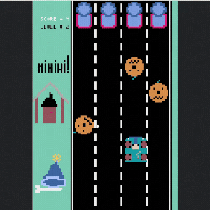

Step 2: Imagine the Game
To create a game, It is important to imagine the gameplay: the goal, how it work ...
Like the theme of the game is Halloween, I imagine a game where the main character shoots at pumpkins, pumpkins that come out of cannons and have a spin effect, and go straight and south direction. If the character touches a pumpkin with one of his bullet, a candy bowl appears in the place where the pumkin was touched, and the character has to go into this place to collect the candy bowl.
If the character collects a candy bowl, his score goes up by one point, but if a pumpkin go out of the screen, he loses a score point.
Also, if her score reachs into 10 points, he climbs up a level, and climbing up a level means that pumpkins go faster. But if her score goes under 0 points, or a pumpkin touches the character, the game is over.
To make simply, the goal of the game is to shoot pumpkins, collect the candy bowl inside, and dodge the pumpkins.

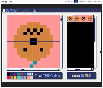

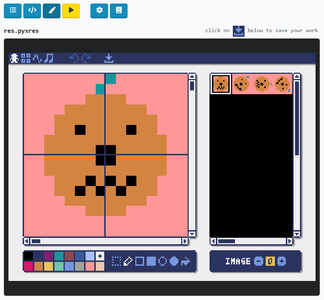

Step 3: Draw the Pumpkin
Now that we know the goal and the gameplay, we are going to design each element of the game.

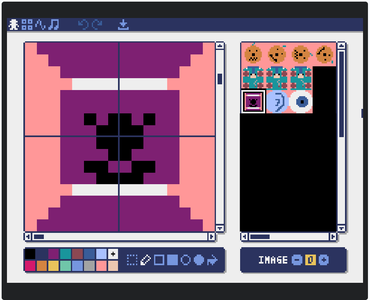

To start, like you can see in the photos, we are going to design the pumpkin. For this, we have to go in the pyxel drawing part of pyxel studio and, as I want to give a spin effect for the pumpkin, I draw 8 phase of different spin position.
And as we can observe, I change the color of the background instead black color initially, because I use the black so If I have conserved it as background, all black colors parts will become transparent when I will display It on the screen. So It is why I invite you to take a color that you don't use as background color.

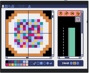

Step 6: Draw the Cannon and the Candy Bowl
Then, we draw the cannon and the candy bowl. As you can see, I keep the black background for the candy bowl because I don't use this color so it does not cause transparence problem.

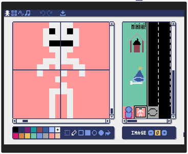

Finally, to close this drawing part, we draw elements for the end screen. A skeleton to indicate that the player lost the game, and an image to indicate the button to press to restart the game.

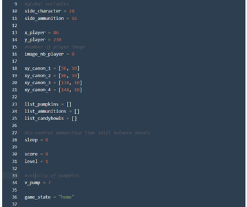

Then, we define global variables. Global variables are very usefull when we have values that we use several times.
Side_ammunition and side_character variables are going to be usefull to manage collisions, xy_canon_1 - 2 - 3 - 4 are the coordinates of the cannons on the screen. Then, we have list_pumpkins, list_ammunitions and list_candybowls variables, which are each, the list of coordinates of pumpkins, ammunitions, and candybowls that we have to display on the screen. And game_state permeted to have the state of the game: home, play, or end.

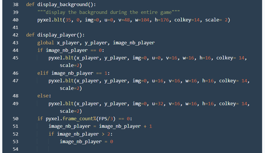

To start, we have display_background() function which permeted, as its name suggests, to display the background. We have aslo the display_player() function which permeted to display the character and to give the movement of smoke.

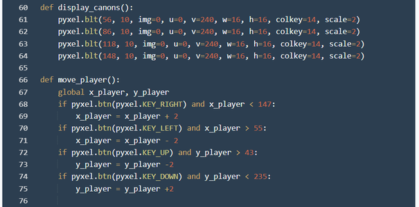

After, display_canons() permeted to display the 4 cannons along the game, and move_player() function permeted to move the player by using arrows keys.

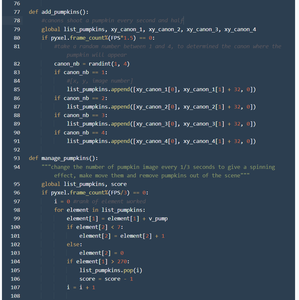

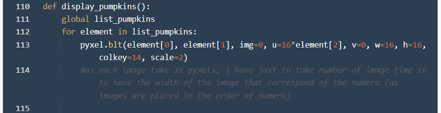

Step 12: Add, Manage and Display Pumpkins Functions
Then, add_pumpkins() function add a pumpkin every second and half, pumpkin that comes out of a cannon taken at random. manage_pumpkin() permeted to make move pumpkins forward, to remove pumpkins out of the screen and to remove a point from the score when a pumpkin go out (behind the character) . And display_pumpkins() permeted to display all pumpkins in list_pumpkins.

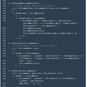

Then, we have to manage all shocks. Firstly, shocks_pumpkins_ammunitions() function detects collision between a pumpkin and an ammunition, removes these authors of the collision and put a candy_bowl in the pumpkin place. Secondly, shocks_character_candybowls() detects collision between the character and a candybowl, in this case, it removes the candybowl and add a score point. And thirdly, shocks_character_pumpkin() function detects collision between the character and a pumpkin, in this case, the game_state variable is changed into "game_over".

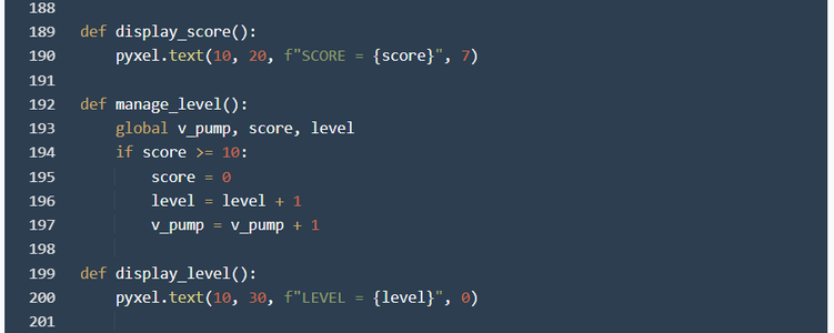

After, display_score() function displays the score on the screen, manage_level() adds a level point when the score reaches 10 points, reset score to 0 point and add one pyxel per 1/3 second in the velocity of the pumpkins v_pump. And display_level() permeted to display the level on the screen.

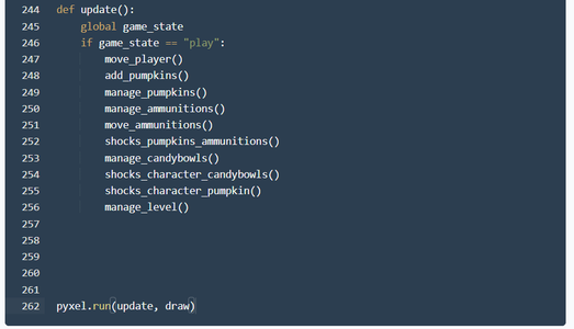

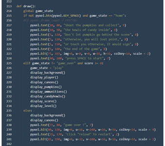

Step 17: Draw and Uptade Functions, and Put the Game on Road
Finally, we are going to put all functions that we define before into two categories and into two functions: draw() and uptade(). We are going to put all functions related to display in the draw() function, and all functions related to management in the uptade() function.
In the draw() function, we are going to manage the display during the before game, when game_state == "home" (the home page) and the after game too, when game_state == "game_over".
The uptade() function will be active only during the play time, when game_state == "play".
And then, pyxel.run() permeted to put on road functions inside during all the gameplay time so we are going to put draw() and uptade() functions inside as parameters.
