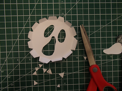

You'll need card stock, a knife, scissors and tape. Start by drawing a ghost face on a plain piece of paper. I made two: a scary jack o' lantern face and a more classic howling ghost face. Cut the face from the piece of paper with scissors. This will be your pattern.
Tape the face pattern to the card stock. Cut out the eyes and mouth with the exacto knife.
Draw notches around the edge of the pattern. Draw a circle about 1 inch out from the edge of the pattern edge. These notches will allow you to fit this flat piece of paper onto Clyde's round dome.
Cut out the paper mask. Follow along the circle you just drew. Cut the notches out carefully. Watch that you do not cut to far into the mask when you cut the notches. Cut up until the edge of the original mask pattern. Bend the notches in slightly.

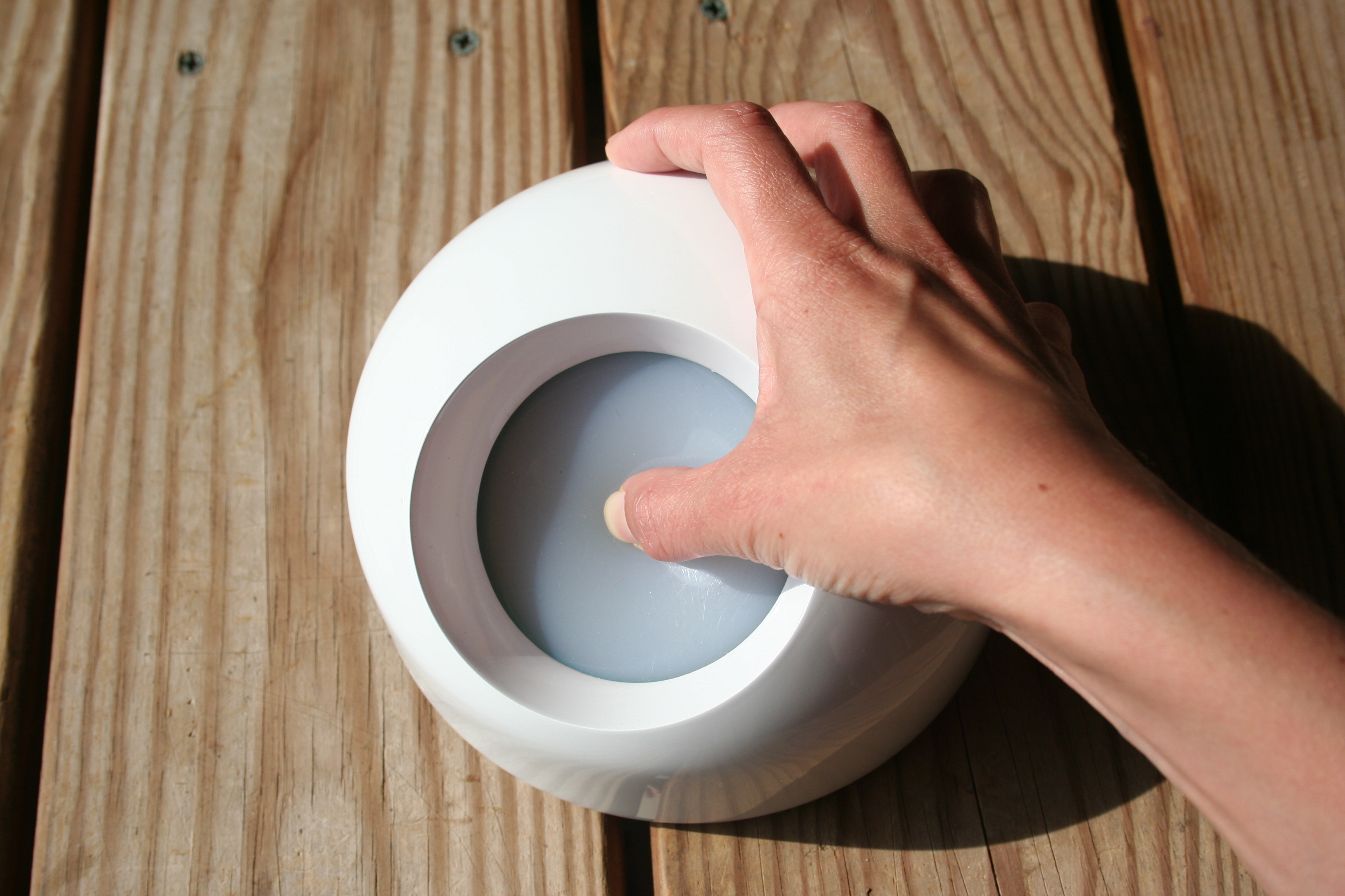

Tape the mask over Clyde's eye button.
Plug Clyde in and see the results.
Now check it out with the lights out. Cool, right!?

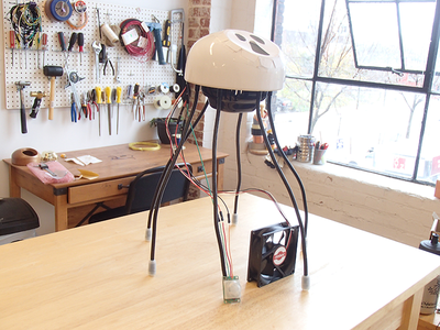

Put Clyde's lid back on. The wires for the fan and the motion sensor need to fit between the lid and the base. This can be a bit difficult, you'll have to make sure that the lid is properly aligned with the base and then carefully press the lid down.
Stand Clyde up and place the fan and the motion sensor at his feet.
Attach the motion sensor to one of Clyde's feet with the zip tie.
Place a small white sheet over Clyde's head. Make sure the motion sensor is sticking out.
