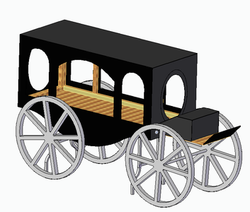

Step 1: Get Familiar With the Project
From my goofy sketch to the finished project...
Before you dive into the detailed drawings, you may find it helpful to play with interactive 3d model in the pdf file below. Download and open the file using Adobe. (If it doesn't seem to be opening, select "Trust this file one time" and click on the white space, and it should open in a moment.) You can use your mouse to rotate and zoom the model, and if you have Adobe Pro, you can also use the controls to turn the panels on and off, take measurements, etc. This will help you visualize the project before you start.
When you are ready to build, you will refer to the Bill of Materials and the drawings of each part of the hearse (attached as pdfs to each step) to see what to cut and how it fits together.
Here's an overview of the design:
- The hearse is constructed mostly from separate, lightweight panels so that it can easily be disassembled for storage.

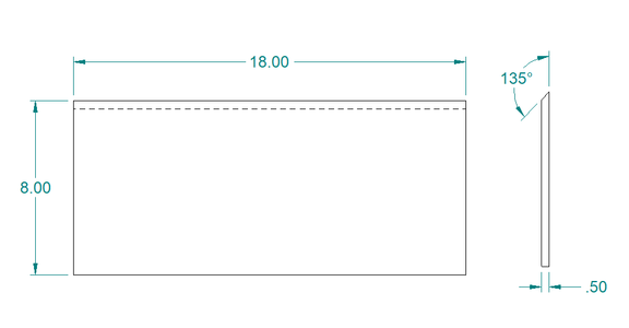

Following the drawing for the Base, measure, mark, and cut out the plywood for the hearse base / tongue extension.
Refer to the Bill of Materials list for the Base. Measure, mark, and cut the 1" x 2"s for the Base frame. Glue and nail the 1" x 2" strips to make a rectangle on the base, with the narrow side against the plywood and set 1.5" inside the edges of the plywood compartment floor, as shown in the Base Assembly drawing. (You will drill through the panels and into this frame for your assembly bolts later.)
Following the drawing for the Footrest, measure, mark and cut out the footrest from a leftover piece of the 1/2" plywood. Make a 45 degree angled cut along one long side when cutting. Glue and nail the section for the driver's footrest to the front of the tongue, so that it comes up at about a 45 degree angle. Cut an 18" long piece of 1"x 2" and lay it on top of the joint, and glue and nail it to both the Footrest and Base plywood from both sides, to strengthen the joint. (Note: this last piece is not shown in the drawings or Bill of Materials, because I added it when my footrest joint began to fail. A more elegant finish might be to cut several 135 degree obtuse triangles out of plywood and use them as braces.)

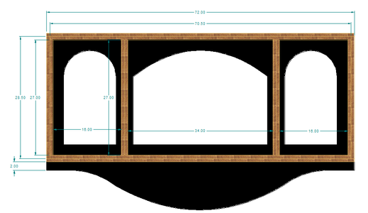

Step 4: Make Compartment Panels
Download and print out the drawings for the Front, Front Assembly, Side, Side Assembly, Back Assembly, and Top Assembly below. (Note: full dimensions for the Back and Top are on the Assembly drawings, so there is no separate drawing for the Coroplast for these two panels.)
Following the dimensions in the drawings for the Side, Front, Back Assembly and Top Assembly, measure, mark, and cut out the Coroplast for the skin of each panel. (Be sure to cut out two Sides.)
Cut window openings in the Coroplast for the Sides as shown in the drawing. NOTE: For the front and back, if you are using fancy oval frames for the windows, make sure to use your selected picture frames as a guide for cutting out the oval openings on the front and back, leaving enough room for the frame to clear the driver's seat block. The oval openings shown in the drawings are only notional. If you don't have frames for these, you can cut as desired and trim the windows out with pipe insulation in Step 3.
Using the list for each panel in the Bill of Materials, measure, mark and cut the necessary lengths of 1" x 2"s for each panel.
Assemble frames with glue and brad nails, creating lapped joints at the corners, as shown in the Assembly drawings for each panel. Note: using the doubled 1" x 2"s allows you to easily create strong joints without having to shape your board ends. Be sure to follow the drawings so that you are nailing in two directions in each corner and creating a sturdy (and square) frame.
Position the frames on the the Coroplast as shown in the Assembly drawings, securing with Liquid Nails and staples. Staple from the outside, preferably where the dimples from the staples will be covered by decorations. Pay attention to where and how much the Coroplast should extend beyond the frame so that the corners will fit together properly when the panels are assembled.
At this point, I spray-painted the inside (wooden frame side) of each panel black.

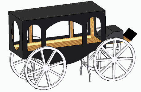

VERY IMPORTANT: "dry fit" the panels on the base as shown to make sure they fit properly and make any adjustments needed! Small gaps at the corners are ok, because they will be covered by the foam columns at the end, but you want to be sure everything is good and square.
Drill holes to bolt the side, front, and back panels to the base and the roof. (See the dry-fitted photos for approximate placements. I think we used 6 bolts on each side and 4 on each of the front/back.) I used 4" long 1/4" bolts with T-nuts on the interior. You will need to drill through the overlapping layers of the wood framing to join the panels to each other and the roof, and hammer the T-nut into the innermost piece of wood. Then putting the bolts in with a driver or ratchet from the outside will be easy.

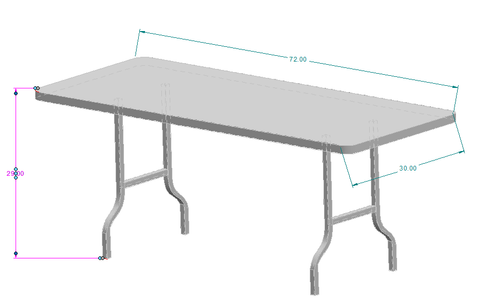

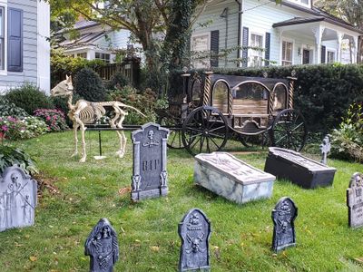

Step 7: Notes on Assembly
Even though each of the pieces is really light (except the plywood bottom!), this is a lot easier to do with a couple people and a power driver / socket.
Position and level your table (or sawhorse base) first. This gets hard to do later! You may be able to push table legs into the ground, but we found it was more stable to put 2"x 4"s under the table legs to keep them from sinking in too much.
Put the base / seat assembly on the table. Now is the time to add your casket and occupant--it will be harder once you start assembling the panels. You will also want to add lights (if you didn't already add them to each panel) before sealing up the four sides of the hearse.
Bolt the side, front, and back panels to the base. Fit the top in place and bolt.
Position the corner columns to the matching Velcro at each corner and top with finials.
Insert axle supports into the ground about 6". The support for the back wheels goes under the table at the back, and the support for the front axle goes under the driver's seat. Thread the axles through and add wheels and caps on each side.
To add traces for the horse, tie the front end of the black 1" x 2"s to the horse's harness and lay the other ends over the axle supports. (We also used a heat gun to do a little "plastic surgery" on our horse and skelly so their heads would droop a bit.)
Happy haunting, and please let me know if you build your own version or have any questions!
