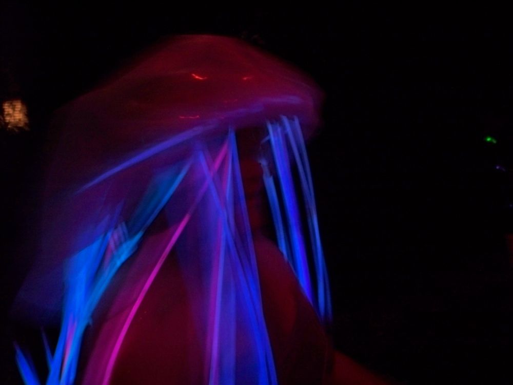

This is a visually stunning fancy dress costume using LED rope lights and a plastic washing basin to create a deep sea bioluminescent jellyfish thing.

Step 3: Mount the LED Ropes to the Basin
I got a translucent (this is important, so light glows through it) basin from a pound shop (dollar store). it was about 50cm diameter, which is an ok size. for 18 tentacles.
I used hot glue to mount the battery end of the lights to the inside of the basin.
Use sandpaper to rough the surfaces first, then clean them thoroughly so it sticks better. people WILL pull your tentacles.
Leaving 5cm of plastic tube inside the basin. This will let you use a cable tie around this soft bit of the rope and leave everything nice and secure.
Step 4: Tentacles in Place
wow, ok done.
I also put 3 LED rope lights in the top of the basin to light the bell of the jellyfish. If I did it again, I would do more lights in the basin, as it really adds to the effect.
I used even more hot glue to fill all the gaps between the LED rope lights and the basin, before tightening up the cable ties. I'm glad I did this because a bunch of girls in a dance tent utterly mauled my tentacles, but it all held together.
Step 5: Wiring It
I now pulled all the batteries out the rope lights, and used a naked solid wire to go through all the negative terminals of the lights. I soldered it to each terminal, then hot-glued it in place so it wouldn't go anywhere. I then repeated the process for the positive terminal. Remember to glue it all in place so it won't go anywhere - if the 2 wires touch, it shorts everything out.

Step 7: Mounting It
you get any comfortable helmet with holes in the top, then drill corresponding position holes in the basin , and use hot glue and cable ties to mount it on.
I then glued the control box to the back of the helmet, and ran ries down the battery pack on my belt. This is because I was worried about ahving too much weight on my head.
If you were using C or AA cells though, I think you could mount them on the helmet too, and probably not sustain lasting neck damage.
Step 8: Done
there you go, done! mount up and go and freak some people out!
