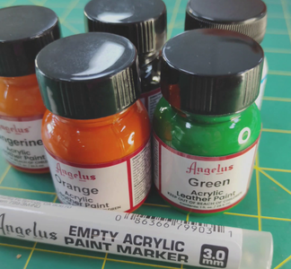

Leather paint and brushes. Angelus is perfect

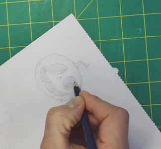

Step 1: Draw a Spooky Pumpkin
Use a pencil and your imagination to draw a spooky pumpkin. Make sure it's a design you'll be able to paint later.

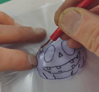

Step 4: Copy the Pumpkin Onto Clay
Lay the traced pumpkin over the polymer clay, and use a modelling tool to trace the outline, leaving an indentation.

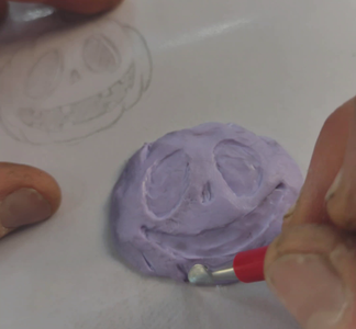

Step 5: Model the Pumpkin
Use the modelling tool to create indentations for the eyes, mouth and ridges, smoothing the edges down.

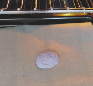

Step 6: Bake the Clay
Put the polymer clay onto a baking sheet, and bake in the oven until hard.

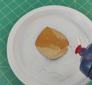

Step 9: Soak Your Leather
Soak one piece in water until fully saturated.

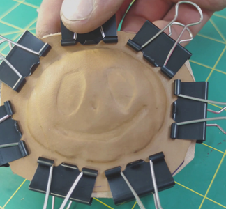

Step 11: Clamp and Dry
Leaving the clay inside, use bulldog clips to clamp the front and flat back pieces of leather together while the leather dries.
Step 12: Remove the Clips
Once the leather is dry, it will maintain its shape, and you can remove the clips and clay.

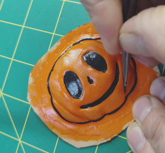

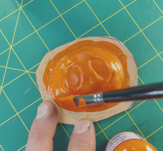

Step 14: Paint Your Pumpkin
Using Angelus acrylic paints, colour and outline the pumpkin face, as well as a stalk. Use multiple shades of orange for shading, and paint a clear outline.

Step 19: Cut It Out
Cut out the pumpkin approximately 1mm to 2mm outside of the stitching using a craft knife.
