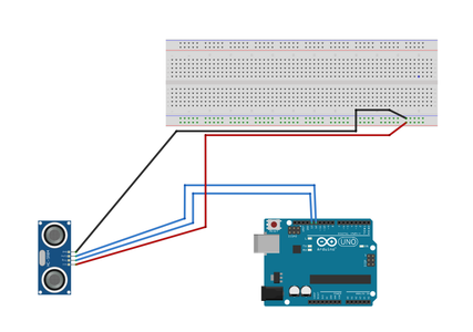

Step 1: Wire Up the Motion Sensor
First you need to build the sensor into the circuit, for this you need to follow the diagram above. As you can see the sensor needs to be connected to 4 different spots. The + line which is where we will later on connect our power source to, the 13 and 12 digital pins and the - line which will later on be connected to the ground. The Motion Sensor will be attached to the coffin so it can sense someone's movement and start the circuit if it gets close enough.

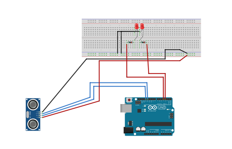

Step 2: Wire Up LED's
Next on we will build both LED's in, these will act as the eyes of the skull. Each LED needs a resistance of 220Ω, they are connected to the digital pins 4 and 5 and to the ground. They will be fed 5V from the Arduino and need to be connected to the - line (our ground).

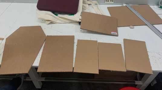

Step 6: Get the Coffin Ready
To achieve this, we will use cardboard, we will look up a coffin pattern and cut it and then stick the bottom part and the "walls" with silicone. The door of the coffin needs to be cut in half and attached to the walls with a door hinge. Once its done we will apply spray paint and decorate it however we want it.
