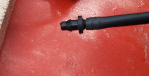

4.an adjustable watering sprinkler like the one in the picture
5.fat and thin plastic watering pipes(usually used for automatic irrigation system)

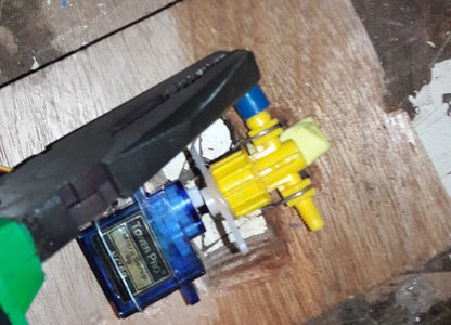

First of all connect the servo to the sprinkler. In order to achieve this, hot-glue the removable servo arm onto the sprinkler.
You should be quite careful in order for both the sprinkler and the servo to be able to rotate around the same axis.

What you need to do now is to mount the servo onto a piece of wood.
Start out with a rather big piece, so that you can later cut it to fit exactly inside the mask.
Make a hole in the wood so that the swiveling part of the servo-sprinkler system can rotate freely.
Then place the two parts above the hole,making sure that they can rotate, and mark down where the wire will pass through the wood.
Now you can make the small holes with you drill.
After that, you re ready to tie the servo-sprinkler onto the wood using the wires
*please refer to the pictures for deeper understanding

Connect all the tubing following the pattern shown in the pictures
Afterwards remove the cap so that the sprinkler will spray forward
