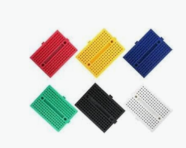

Mini solderless breadboard $7 for 6
https://www.amazon.com/Eiechip-Breadboard-solderless-breadboard-Arduino/dp/B07RSBPFN7/

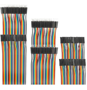

Assorted wiring kit $6
https://www.amazon.com/EDGELEC-Breadboard-Optional-Assorted-Multicolored/dp/B07GD2BWPY/

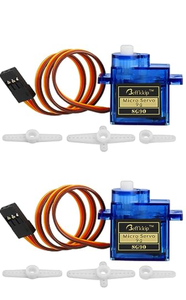

2 Micro servos $8 for 4
https://www.amazon.com/Micro-Servos-Helicopter-Airplane-Controls/dp/B07MLR1498/
