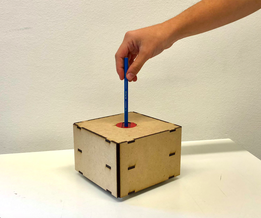

Step 1: Blueprints
Here are the measurements for the structure. We cut ours on a lazer cutter but if you don't have one you can print them and cut them out with a scalpel.
Step 2: Structure
After cutting the pieces, assemble the structure.
Slot the stand together and then fit the top circle to lock it into place.
Print the animation you want and glue that to the outer disk.
